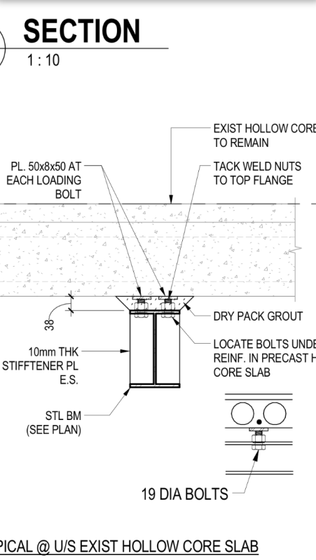

KootK: The angles are a good idea. I'm not sure I'm comfortable with there not being a connection between the beam flange and angles. I suppose it still provides the bracing as long as the angles are installed directly against the flange on each side.

For what it's worth, you see similar details in renovation applications often. These aren't my handiwork.
