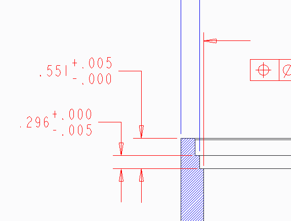

I don't know why you're wondering about protrusion vs cut, or even where that comes into relevance in assigning unilateral tolerances. Maybe I could answer more directly if I understood.
Regardless, no, 0.296 +0/-.005 would absolutely never be read as 0.296 +.005/0 because that's a completely different set of acceptable values.
It doesn't matter if it's cast, forged, welded, bored, milled, punched, or spun and finger-shaped from clay by the ghost of Patrick Swayze.
The acceptable values for that dimension are between the 0.296 maximum, and 0.291 minimum.
Assigning the tolerances on those dimensions has only to do with the design, assembly, or functional requirements which can not be certain to me from what is presented.

For cuts, you cant add material back. Say that 0.551 is the diameter hole, then the tolerance is correct. You cant never have 0.551-0.005. Since that step is a cut, i would imagine same rule applies

My interpretation is that the designer wants the depth to be from .291 to .296". There are no rules for which direction tolerances should go. The machinist's job is to hit the dimensions, as specified.

Whether or not the cut is an ID, OD, counterbore, or boss has nothing to do with how the dimensions and tolerances are expressed. Regarding stacked limit dimensions, the standard says that with stacked dimensions, the larger value goes on top and the lower on bottom (para. 2.2(a) in the 2009 standard). No consideration is given to whether it's and ID or OD. While the current version of the standard doesn't address the order in which stacked tolerances appear, the draft of the new version does have it delineated.

Some organizations like for material removal operations that the nominal number value be the first one a machinist would hit and the tolerance allow for more material to be removed after that.
It's not a requirement of any standard, just a local preference.
External features would be nominal +0/- tolerance; internal ones nominal +tolerance/-0.
Processes such as EDM will want the kerf of the process to be taken into account.
None of these need to be taken into account on the engineering drawing but should be considered for manufacturing process drawings.

I've heard similar before, and also heard opposite, and also heard that they should always be bilateral +/- tolerances so there's no mistaking where to 'hit it in the middle'.
No one is more correct than another. It's all illogical crap to suit someone's particular flavor. It's not something particular to a process; it's a request specific only to a /person/ and so I don't really respect it at all as any form of legitimate practice.
My personal experience is that ideas like that are typically to make up for lazy or incompetent machinists or simple bad practices in programming or tool settings.

JNieman - that's why I prefer to use +/+ tolerances or -/- tolerances. 2 +12.03/+11.97, for example. Makes them think.

When you say that it isn't a requirement of any standard do you mean that since Y14.5 is a voluntary standard that nothing in it is a requirement? If so then I agree, but if you're saying that the order that stacked limit dimensions should appear isn't addressed, then I refer you to 2.2(a) of the 2009 standard.
CH,
It currently places the plus value above the minus value and in the case of one of them being a nil value, the nil value will have the opposite sign of the non-zero value for inch tolerancing. All the illustrations show the plus value above the minus value and the nil value with the opposite sign of the non-zero value but no verbage locks it in that way. Of course since this is still in draft, it could change but I hope not.

In that case 2.2(a) also addresses limits expressed in a single line as in your 20:59 post. Low value first, then high.

I think a lot of this could be ironed out if the original drawing made use of the dimension origin symbol. It's confusing right now because we don't know what is being measured from what.

I think it would be weird to see a dimension origin symbol starting at the bottom of the hole. Maybe it is just me. I find the OPs drawings to be completely interpretable.
In general, when I dimension features like this, I use the top as the origin. The tolerances, as shown, do not support that scheme. The distance from the bottom of the hole to the feature, seems to be critical. If I saw the design, I might disagree with the drawing. My first assumption has to be that the designer/drafter thought this through, and that they know what they are doing.
