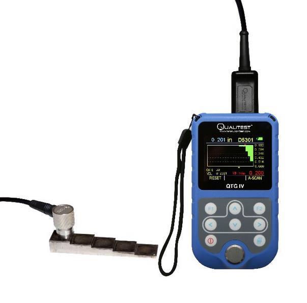

I am working in a low budget company where we are issuing an order of steel plates API with 15mm thickness
the consultant is insisting on doing an Ultrasonic test of the plates which is not addressed on the RFQ phase
my question
is the UT test required by any code or its subject to the recommendation of the client/PMC
codes are
ASME B31.4, API 1104 ,ASTM SA370

What does it say in the specification, especially one produced for this piece of work instead of a general spec. "steel plates API" is not a specific terminology.
The requirement for UT testing is normally within a project specific document, but is generally considered a requirement for girth welds and seam welds and 150mm back from them to discover laminations.

The ultrasonic test is inexpensive and takes just a few minutes withe the handheld ultrasonic tester.

UT requirements for pipe skelp (plate) is the province of the Purchaser or end user (Owner/Engineer). It appears that you have a Change Order coming assuming this "consultant" is the Owner/Engineer representative. Provide the added costs and see if he accepts.

when I said low budget its because we cant absorb the increase of the UT test, because it was not specified by the client and I wanted to make sure no code or standard obligates me to do so ..
the UT requested is for the plates before the fabrication of the final product .

Dear all we finalize that issue regarding the UT and after many brain storming we get to the points as below
- the plates should be tested for lamination and that's mandotary as per API 5L and Astm A370
- after the rolling and as per general caution descriped in ASTM A370 the mechanical properties of the plates before any rolling or fabrication or any heat input fabrication may not be representative as after the rolling so we had to do the tensile,bending ...etc again
- we agreed upon a percentage and a method to do the lamination test as per code and it's wasn't that costly but it was hard and it took a lot of time.
- and we also did the mechanical tests after the rolling before launching a full production
