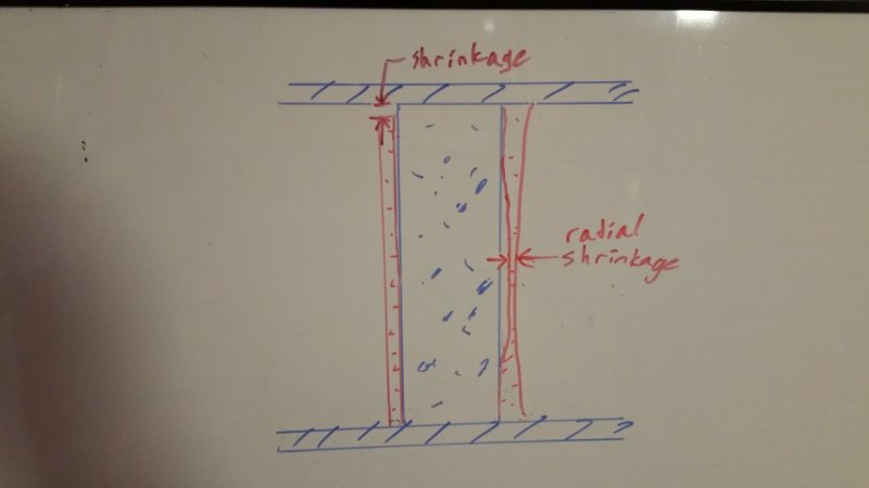

I'm reviewing a design where an existing round concrete column is being encased with 6" more concrete all around. Roughening for composite behavior, new cage, and all that jazz.
I have this picture in my head where the new concrete tries to shrink but is restrained from doing so by it's bond with the existing concrete. That, in turn, result ins distributed cracking and puts the new longitudinal rebar in tension and compression alternately from one crack to the next, in effect, prestresing the original column.
So my questions are these:
1) Am I considering this correctly?
2) With a prestressed column that one might get from a precaster, the prestress does not add to the axial load on the column for stability purposes. The same would be true here, yes?
3) Would you be specifying a low shrinkage mix for this application? For what it's worth, the contractor would like to use SCC for obvious reasons.
4) If you were to specify a low shrinkage mix, how would you determine the performance characteristics to specify here?
5) The new concrete will be rather heavily reinforced. Should that effectively eliminate my shrinkage concern on it's own?
This is a stocky parkade column that is in need of additional compression capacity. Moments and slenderness will be ancillary concerns.

1) Doesn't sound unreasonable, the "composite" addition will try to shorten the length of the column effectively similar to a prestress. If it cracked though, wouldn't you loose the "prestress"?
2) Doesn't it add to P-little delta effects? Either way I wouldn't consider any "prestress" in the design unless it was unconservative to do so.
3-4) Unless I had a bunch of these to do and the cost to going with a no-shrinkage mix was large, I would definitely go with a no-shrink mix. I'd be looking carefully to make sure the mix isn't one that expands initially and then contracts down to get the "no-shrink" concrete. 100% agree with using SCC on this. I'd even encourage it with a little external vibration. Whenever we've done tight pours (around 6" to 8" thickness) with a bunch of cages of rebar and a long fall for the mix, we've had issues with bugholes and other finish issues due to entrapped air. Never did come up with a perfect solution after 14 or so pours in the same form but light external vibration at key locations didn't over-consolidate the mix and seemed to help a little bit. If you can pour in segments or avoid long falls for the mix it will help but I'd still be using SCC if it were me. I'd probably include a few witness holes as well.
5) I'd say "maybe" (but that's mostly a guess). I'd say shrinking away from the bond with the column is a concern and your reinforcement wont help you here. For longitudinal shrinkage I'd expect that the heavy reinforcement will resist it but you still might have some issues due to shrinkage at the ends where the reinforcement isn't fully developed or because of restraint where the existing column connects into the structure.

I've been pondering that as well. I feel that the stuff that is the wrap (conc + bars) will be trying to shrink. End of story. Thus, cracked or not, the wrap will be in tension over all and the existing concrete will be in compression overall, whether the wrap is cracked or not. This, at least, until load is applied.

Interestingly no. The tendency for the tensioned bits to restore the member to straight (load balancing-ish) perfectly balance the P-Littles.

More worried about it trying to expand longitudinally, pushing against the top and bottom of whatever the column is connected to causing longitudinal compression, and being unable to push these relatively rigid supports up; buckling outward away from your existing column putting high tension loads on your bond. I'm not sure if this is even what would happen but there are definitely mixes out there that have balanced non-shrink properties so that they nether shrink nor expand. You're right that if it didn't "buckle" outward then it would be beneficial to expand longitudinally.
Quote (KootK)
Oh my. Another thing that hadn't occurred to me. I'd imagined that the concrete would shrink towards the existing column transversely. Your thinking is that the ties would prevent that and the concrete would shrink away from the existing columns. At present, the bond does not include any mechanical anchorage.
Here's the two issues I can see happening with shrinkage:
The longitudinal shrinkage pulling away from one end would cause high shear stresses on the bond. Maybe not an issues but worth considering.
The radial shrinkage might cause the concrete to shrink towards the reinforcement in the added ring of concrete and thus pull on the bond to the existing column. I will say that I haven't really seen this in our precast forms; there's definitely some radial shrinkage but even with a smooth surface and form oil there's still a definite bond to the steel form. I'm not sure if this is just the concrete shrinkage creating a vacuum or if it's an actual concrete to steel bond, though. Regardless, PCI recommends ~130% of the self-weight for precast stripping loads from steel forms so that force is definitely real.
Overall, the uncertainty on what the shrinkage/expansion might do to your bond was why I felt a non-shrinkage mix was easily worth it to avoid loosing sleep. Might be worth using a fancy bonding agent too as I almost never see anyone prepping an existing concrete surface properly for proper bonding and to not steal water from the new concrete.

I see it happening like this:
RE: Wrapping Existing Column With New Concrete - Low-Shrinkage Concrete Mix
Thanks for that BowlingDanish. I see it the same way.

1. Shrinkage is volumetric not linear. Restraint of shrinkage in one direction will increase it in the other directions. Restraint can be due to reinforcement (fibers or rebar), hardening of the resin/cement so it is no longer fluid, and mold surfaces. Shrinkage problems are more pronounced in closed mold cavities than in molds with one open surface.
2. When aggregate particles are touching, they cannot get any closer together and bulk shrinkage cannot occur. Stress will build in the cement between particles.
3. Bubbles and air-entrainment are stress relievers for shrinkage. The bubbles simply grow very slightly larger to accommodate shrinkage.
4. Your drawing depicting radial shrinkage is not correct in that radial shrinkage will cause the concrete surrounding the column to pull tighter to the column.
After thinking about it I agree, that makes more sense that you're taking the circumference dimension and making it smaller. I'm sure there's some thickness loss as well but I imagine it's insignificant compared to the change in circumference. To satisfy my curiosity I'll have to take a close look at one of our manholes coming out of it's form to see if I can tell which way it shrinks.
