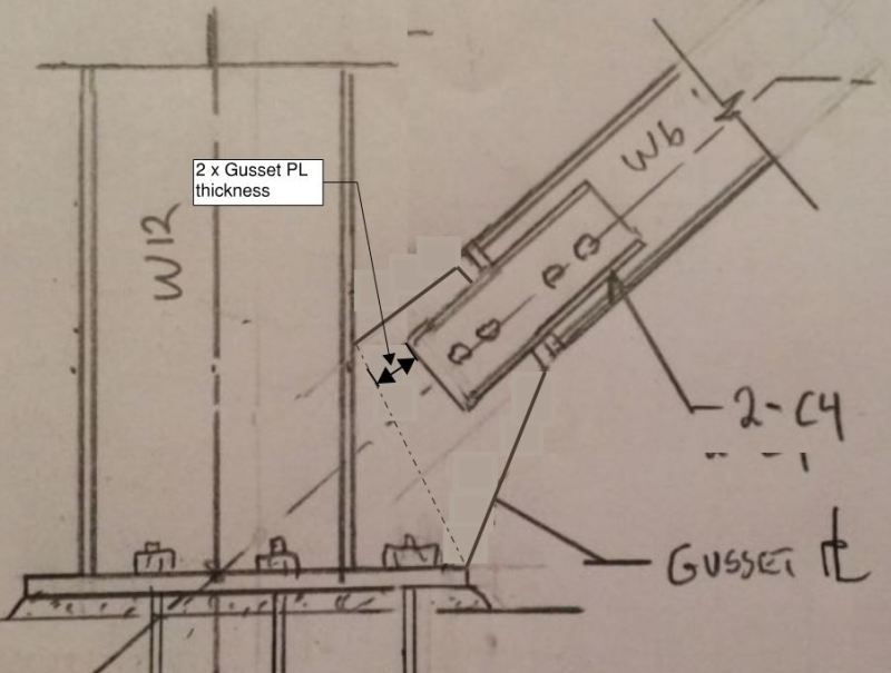

Kootk, Please look at attachment.
Either column orientation, after I get a detail I can engineer it by DG29 design of vertical bracing.
Jed, I will try that scenario... Just never used it before... I'll calculate and see if it works.

Ok thanks for the input guys. Another question I have is, in order to reduce eccentricities does my bracing plate have to bear against the base plate?
RE: Bracing Connection at base
If your column were wide and your angle steep you might be able to stay concentric without hitting the base plate. That's rare-ish though and, based on your sketch, I suspect that you'll need to grab a little base plate.
In short, yes. You want the work point of the brace connection to be at the intersection of the centerline of the brace and the centerline of the column at the top of the baseplate, or you have to deal with the eccentricities. AISC does a good job showing the calculations in the manual chapter 13.

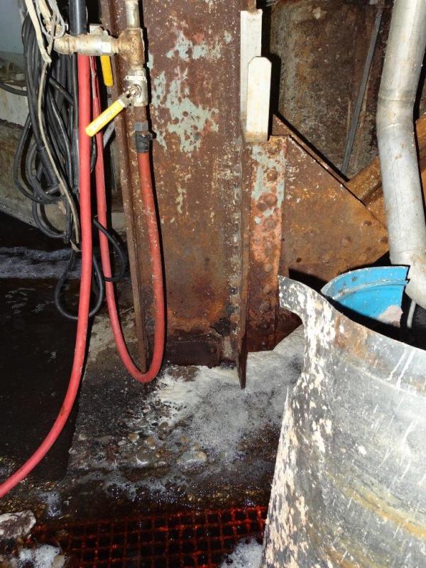

Obviously I can't change your bosses mind but my previous boss/mentor had similar reservations about HSS sections in industrial settings. After doing a lot of work with steel corrosion in these settings I found that other than surface rusting issues, most of the major corrosion issues were leaks; direct steam/condensate exposure (such as condensate traps), direct exposure to process chemicals, and areas where water could pond against the steel. Overall, if left with no maintenance or in a bad environment, no coating will hold up. Here's a picture of a typical mill column/brace:
It was quite typical to find rust on almost every surface of a column/beam with no coating left. However, a lot of steel had very little section loss. The real corrosion issues were caused by poor setup of the process. In the picture there was a process drain that they let flow on the floor around the column and splash up onto the brace (note the missing column web). Also, note how the brace is a wide-flange turned flat. Terrible idea, every time I saw this the web was rotted out at the bottom end where condensation collected (avoid flat/enclosed surfaces where anything can pond).
Long story short; I don't believe the lack of a coating on the interior of a HSS is going to significantly impact your corrosion resistance. However, if you do expect direct exposure to water/steam/chemicals then either hot dip galvanized or stainless steel will probably be what is required regardless of your section shape. But, if you do go to a high-end corrosion resistance material/coating then you should use an HSS anyway for least weight (stainless HSSs are quite common in paper machine frames). It's also worth noting that I don't recall any time I saw a carbon steel HSS used that it seemed to perform any worse than a wide-flange. I think most people in the industry just shared that mentality of HSS = hidden corrosion.
It's entirely worth noting that I would not put end plates and seal up the HSS. Any condensation left inside would undoubtedly pool on the bottom and corrode it. Leave it open; better, cheaper, plus easier to inspect.

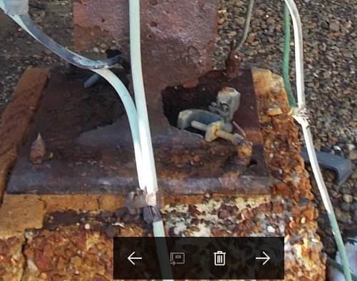

I got some funny ones. This is still in operation lol

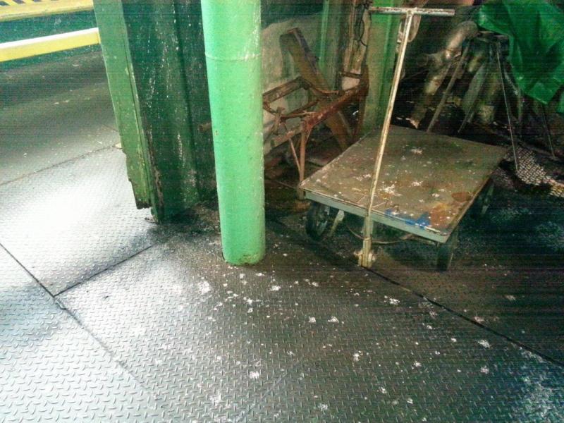

Oh, and I did manage to find a picture of the infamous industrial HSS. Don't get too close, it could collapse at any minute! This column was splattered with pulp at the top but the wide flange column right next to it looked slightly worse.

Hey, that looks like it's inside a building. Not fair.

I'd still want to do something like this in a seismic area, though:
I wouldn't use the detail that I proposed in a high seismic application where stable hinging was desired at the ends of the brace. Rather, I'd stick with schemes that continue the out of plane flexural stiffness of the brace down to nearly the gusset yield line. Slotted HSS or wide flange with flange angles etc. Last thing you'd want at the connection would be a chain of potential hinges.

The code mandates highly recommends the 2t setback for seismic.
Is that the case even for low R-value systems JAE? Not that the 2t is difficult to provide. I just thought that it was only necessary where one plans to develop plastic hinging in the braces.
Thanks for that JAE. The commentary does specifically reference special concentrically braced frames and plastic hinging which strikes me as consistent with my understanding.
The 2t is a relatively minor adjustment. If these connections need to be able to accommodate cyclic plastic hinging for all R values, however, I'd think that a bigger issue would be the kinds of braces and connections that would be acceptable in general. As I mentioned above, there are some schemes that I would definitely not be willing to use in a system that requires stable plastic hinging. To stick with the 2t requirement and then be laissez-faire with the rest seems philosophically inconsistent.
