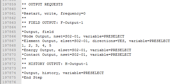

Ahh! That makes sense. I think either of those outputs are acceptable for my purpose (mesh convergence study). For future reference, are you aware of how to force output of all five section points? I can't find an option in "Field Output Requests".

You can get output at all points with:
*ELEMENT OUTPUT, ELSET=SetName, VARIABLE=ALL
1,2,3,4,5

I see... if I'm correct, I think this will do the same in the GUI, then, right?

That'd be my guess, but I generally don't spend much time in the GUI except for results visualization/post-processing. You can verify in the .inp after writing it from the GUI though.
RE: Help understanding-->fieldOutputs['S'].values has two different results for each element
Yeah, it looks like it did it. Here's an image for anyone else's future reference.

Yes, it's the same option.
In /CAE it is easy to have a preview at the input file. Model -> Edit Keywords
