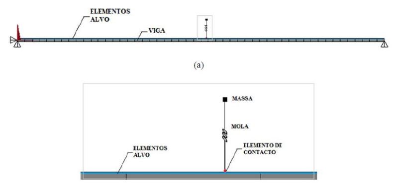

Hello, I would like to ask, if you have time, to help me to solve a simple model problem in ABAQUS.
I’m trying to model a simple supported beam subjected to moving sprung mass. This should represent the movement of a train travelling over a rail with constant speed v. The rail is modeled as a beam and the train is idealized as a lumped mass supported by the suspension systems, represented by a spring, which in turn is acting on the rail.
I have created two parts:
- A beam with a reference point, which represents the point to which the spring is attached
- A reference point with a mass, which represents the lumped mass
Then I’ve created a spring between the two reference points and I’ve applied the boundary conditions and the gravity load.
The fact is that I don't think it's the right way to model it because when I run it, it doesn't converge.
Do you know how to fix it?
Here below I've posted the script that I've done.
