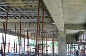

Upside down, it's basically the same as an elevated slab with beams. Similar design process and advantages. For the same flexural capacity and stiffness requirements, the beams will require a thinner slab and less concrete. However, the beams will complicate formwork, require a second pour operation, and increase overall system depth and therefore excavation. You'll also require a slab on grade but I usually try to have one anyway with a conventional raft. You'll need to check horizontal shear friction on the beam pour joint but that won't be a big deal.

whats an elevated slab with beam? can you give some pictures to explain? what if the beams are hidden in the raft? whats the purpose of doing such thing like that?

There would be no point in hiding the beams in the raft. Then it's just a standard raft slab.

Elevated slab with beams pic below.
