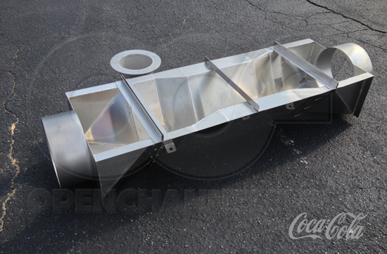

I have 110mm pipe that is receiving outlet wastewater from a treatment system. the flow is continuous but can be zero at times but mostly continuous, It varies constantly diurnal mainly and is very low. I am looking for an alternative way to measure the flow rate of water from the pipe without the use of a flow metre.

Flumes are used for open channel (surface) flow, if I remember well. If that fits the description of your application, you might as well use V-notch or weir, which has 100:1 turndown.

The pipe is never full maybe a quarter way full, it is on a flat surface, a bucket cannot be used since the depth between the pipe and water surface is low as shown in the diagram. the flow rate is approximately 0.47m3/hour, worse case 0m/hour, minimum 0.06m3/hour highest 1.03m3/hour.

bimr, would trapezium flumes fit with the pipe diameter i have and where exactly would i insert them?

In your chamber you probably need to create a weir and be able to measure depth of water over the weir.
Do a search on this site on "open channel flow measurement" and things like this crop up - http://www.eng-tips.com/viewthread.cfm?qid=400406
Try looking up V notch flow meters.
Look like they could be the right sort of thing, but again you will need a fairly accurate height measurement.
Something like this maybe? http://soil.co.uk/products/water-monitors-piezomet...

Ren, if this is for you float siphon, you know the volume of discharge water when it reaches draw down height. Measure the discharge time to deliver that volume of water. The result will be average flow rate.
The manufacturer publishes flow rates for various configurations.

Really cheap and cheerful - Drop a couple of weighted buckets into your chamber. Lift water out until you get just below the outlet pipe. Then lift even more out quickly - measure the water you've now removed and then time how long it takes from when you start for the water to start flowing back down the outlet pipe again... Simples
For something online you would need some instruments like we-ve all just been discussing. You could build a small weir / V notch meter in that pit.
Bimr - that's a nice looking piece of kit. I'll have to remember that one.
