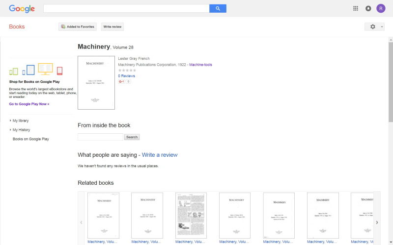

Take a look at pages 1-4 of this September 1921 issue of Machinery. Provides a nice description of form end milling large external herringbone gears. Figure 1 shows a partially shrouded pinion similar to the one on the right in the OP photo above. Figure 3 shows the indexing mechanism used on the milling machine.

tbuelna - I followed the link but am unable to open anything displayed on that page. It appears to be a place for leaving reviews about the book.

Gearcutter - it may be a browser setting interfering with your view as the full book appears for me. It is part of the Google project that scanned millions of books, in this case from the Princeton library. Try another browser or a different computer.

I have tried opening that link on a PC from IE, Chrome & Firefox and all I see is the opportunity to leave a review.
Are you using a mobile device?
In Chrome, this is all I'm seeing -
