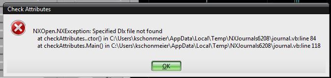

RE: NX9 - VB Code for Attributes (Hope you like a challenge)
I placed both files, the .vb and the .dlx into a folder. Then I ran the .vb file. I got this error.
on the .vb file theres a line "

            theDlxFileName = "checkAttributes.dlx"
edit and put the path of it ex if the files are on a folder called ATT on C:
CODE
Public Sub New()
        Try
            theDlxFileName = "c:\ATT\checkAttributes.dlx"
try and tell-me if it worked
NX8.5 - NX9 - NX 10 - NX11
