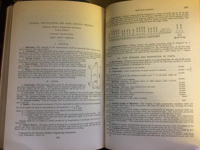

Does this help? It's from the "Structural Engineer's Handbook" by ketchum. Date of book is 1918

Lomarandil: I think the test rivet was representative since the heads on all of those rivets are quite large. I am the contractor - I will remove another when we're back to strengthen the floor beam prior to jacking because I agree that a 1" rivet is unusual. AREMA does say 11 ksi which is in the middle of the range of values in the Cambria document shared by SlideRuleEra. I may just call UMSL for a copy of the D+H spec.

njlutzwe- That is helpful. That and SlideRuleEra's source both reinforce that using the 502 Grade 1 Hand Driven Rivet spec in AREMA is not far off (11ksi vs 10ksi). Moot point here because they're all getting removed and replaced with bolts unless I could confirm a higher grade, but that seams unlikely given the historical sources provided here. In the grand scheme of the reinforcing that the floor beam needs, removing a few dozen rivets isn't that big a deal. And as cool as it would be to find out what they're really worth it's probably easier for me to do than commissioning a metallurgical study.
