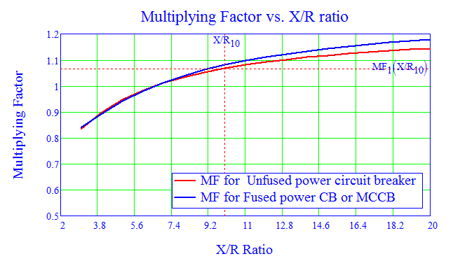

Guys,
Do you know how to calculate MF in Momentary Duty? (I think MF is used to account for DC component of SC and to get the Asymmetrical value from Symmetrical momentary short circuit value.)
RE: Multiplying Factor in Momentary Duty

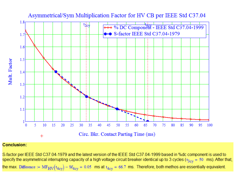

This looks awesome. Do we have anything similar for MV too?
Thanks a lot!
