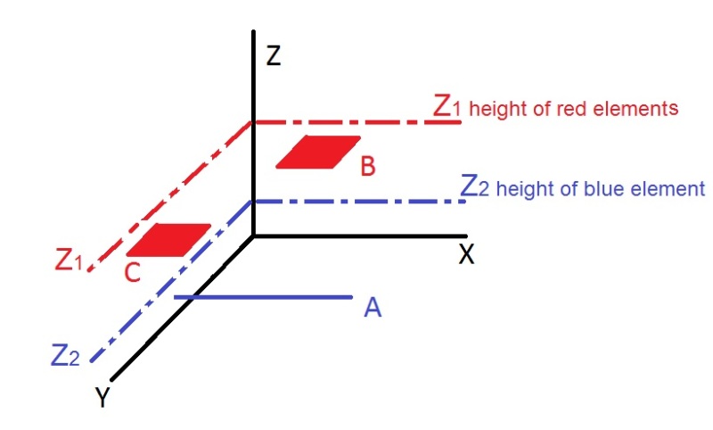

Hello everybody,
I'm Marco, an italian Informatics Industrial Engineer that work on an Optical 3D Scanner and a CMM,
now i have to take a position tolerance (zone 0,4mm), but the primary datum is a compound datum formed by A-B-C
in a Cartesian coordinate system XYZ
A: is an axis in X direction
B and C: are two planes at the same height parallel to Z plane but at different XY coordinate
i don't understand how can define this compound datum with this three elements
if someone can help me it would be really nice.
Thank you in advance and have a NICE DAY!

Please post a drawing
RE: DATUM: compound datum composed by two planes and one axis
GOM ATOS _ ZEISS,
Your datums must locate your part in six degrees of freedom. By the sound of it, your datums locate in five DOFs, and possibly four. Have you got a picture to show us?

SORRY for this poor rappresentation, but for now that is all i can do, I hope that somehow helpful
Tomorrow I will attach the drawing images
Quote (drawoh)
Yes, it is, because the position tolerance has also a secondary and tertiary datum that will Clamp the part.
GOM ATOS _ ZEISS,
Oops. I did not catch that!
Your primary datum is a composite of an axis and two planes. I call up composite datums of two planes or edges, all the time. On a large part with two small, widely separated features, this makes sense. I do not see how an additional axis would work. Three small, widely separated plane faces would normally be called up by datum targets.
Even a crude sketch on a napkin would help us.
JHG
______________________
|position|0.4|A-B-C|D|E|
is written in this way,
also i don't understand the additional axis, I do not understand the element that I have to obtain, and how, from the three elements
anyway, tomorrow I will have the drawing.
and thanks for the help given to here

Sorry, unless you show the datum features and the relationships between them it is not possible for me to develop a definitive interpretation and respond to your question. Maybe other members can offer assistance.

In order for me to determine the motions restricted by the multiple-feature datums, the relationships between the primary,secondary and tertiary datums must be clearly presented and understood. My time on the forum is gratuitous. My employer allows me to take time to respond to as well ask queston on the forum in a "give and receive" approach. I cannot take the extended time to study your "text" in an attempt to understand your dimensioning schema and gather the needed information or ask more questions. A drawing would "rapidly" present the needed information and allow me to quickly respond.

I can interpret your feature control frame as per ASME Y14.5. I cannot interpret your actual features without some kind of drawing. I take it you are working to ISO?
