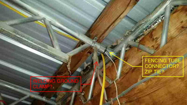

Here is a photo of how they are attached at the front of the garage.
RE: Please classify this Steel Web Truss
You have been engaged to determine the structural adequacy, or otherwise, of the roof framing system?
Some 'funky' connection (or lack of) at this detail:

You don't know the steel material (yield strength), or the type of weld material, or perhaps the weld sizes, or the pipe thicknesses.
So you'd have to either sample and test pieces of these members or it seems like you might need to load test this to know for sure.
Almost zero chance you get any info about the origin of the trusses here. As JAE said, you're going to have get wall thicknesses, weld details, etc...and just go through the analysis. I would start with a very conservative analysis assuming a low steel strength and maybe assume schedule 40 pipe - maybe with all worst case assumptions you're only at half capacity. That will give you an idea how deep you have to dig to verify the roof can take the additional load (or withstand code minimums in the first place). If testing is required, maybe the homeowner has some left over components you can have.
Side note - your diagram of the truss doesn't match the picture. The diagram shows the last web member connecting at the end of the top chord...picture shows the last web member framing in short of the end of the truss. Big difference for the top chord.

I would think assuming sch. 40 is un-conservative. Start with 18ga fence tubing and go from there
Yeah that doesn't look like pipe to me.
Other Fun Concerns:
I don't think you have any real top chord bracing. by the photos it looks like your bottom chord is not braced which means your truss model doesn't work.... Bar joists need bottom chord bracing for the compression-web model to work properly.

To be honest, you are going to have to say that this is not adequate for any additional loads and you cannot verify if it can support existing loads at this time.
They look very much like the proprietary trusses used in scaffolding (as Ingenuity posted). Have you been able to spot a manufactures stamp? Most of these systems are an alloy so be careful if your assuming steel.
Picture for comparison:
As pointed out earlier, there are insufficient/missing chord ties for this "system" to have any real design strength.

Might not be so bad.
- you have top chord bracing at 2' o/c.
- with CHS top chord and end rotation restraints you can probably get by without bottom chord bracing for gravity load at least.
- webs shouldn't give you any grief as they're pretty stocky relative to the flanges.
- At 38, span to depth ratio is high. But, then, it's 26" on centre steel in a light weight system.
Maybe start with some simple deflection estimates then gauge whether it's worth going any further.
