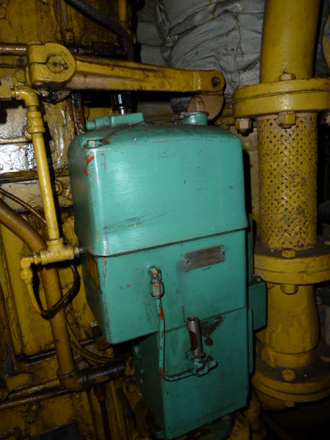

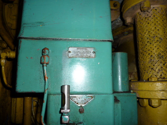

Hello again all, finally got another visit in this past weekend; here’s some more info.
Each of the three exciter lines [port, starboard, and standby] have been confirmed to have four machines, as follows: one DC drive motor, one generator exciter, one propulsion motor exciter, and a four-pole AC generator to supply 60 Hz power to the control circuitry which includes Mag-Amp brand magnetic amplifiers. Incidentally, the Mag-Amp systems I was exposed to when working in generating stations operated at 420 Hz to provide very quick AVR response, presumably not a requirement in this application.
So far I’ve learned that Mag-Amps are used for at least three purposes on board. If I’ve got it straight, the first is to limit the propulsion generator outputs for three conditions, viz., torque limiting, which in reality appears to be propulsion loop current limiting; generator overvoltage; and overcurrent due to regenerative action, viz., when performing rapid or “crash” maneuvering from full ahead to full astern such that if the prop begins to drive the generator it will be limited in its ability to do so, precluding engine over-speed.
The second purpose is to provide propulsion system control from the bridge; turns out the combined control of strength and polarity of generator excitation plus engine governor air bias are all contained within the engine room controller alone, and remote operation of that controller from the bridge is via a pilot motor. Both motive power and closed-loop feedback positioning control for said bridge-to-engine room drive system are provided using dedicated Mag-Amps.
The third is to provide sensing and operating power for the “killer field” control for the main exciters, such that with an engine-generator running but the control selector switches in the OFF position, the presence of generator terminal voltage build-up due to residual magnetism will be detected and bucking field applied until same is reduced to zero.
There might be other ways they’re used that I haven’t found yet...
Tim Hinde and Artisi were asking for equipment pics; here are some of the port engine governor. Sorry for the low quality of the one of the nameplate; the E/R was still pitch-black, and the feeble light of my little LED flashlight doesn’t seem to have provided enough ambient light for our poor little point-and-shoot camera to focus any better than that.

Looks like Woodward sold these governors to EMD in November of 1962.
RE: What I did this past weekend... [marine]
Thanks much, timhinde...but it does make me wonder who or what EMD is, since Still Watch was built by Russel Brothers Limited / Steelcraft Boatbuilders, Owen Sound Ontario, Canada...might EMD be a sub-contractor to Russel Bros., maybe? I sure don't know...

The only 'EMD' that I'm aware of is the 'Electro-Motive Division' of GM, which was renamed 'Electro-Motive Diesel' after GM sold the company to a group of investors back in 2005. They manufactured locomotives, most of which are powered by large diesel engines where a 'governor' would be very useful.

EMD not only made locomotives and their engines, but also diesel engines used for marine propulsion, power generation and some industrial applications, they mainly used Woodward governors, actual model depending on application.
It is likely while these governors originally shipped to EMD, at some point they may have been traded in for exchange or upgrade, then sold to your vessel. There are a lot of old Woodward governors and actuators that look similar to yours on the outside, but may have been either originally sold or modified by a governor shop to work as a direct governor (mechanical linkage for speed adjust), a remote speed set governor that could have used air, electric or hydraulic speed set devices, and maybe even just an actuator, driven by an electronic governor.
Maybe your best bet would be to contact your local Woodward shop, I think its Madsen Controls, and see if they can provide any information on our particular governors.
Hope that helps, MikeL

Hmmm . . . so, based on what you're telling me, Mike, the PG-PL / UG8-PL / SI governor designations may have sort-of "evolved" as Woodward developed better and/or different ways of doing the same thing as required by different applications, making the designations somewhat fluid when back-applied to older models.

Well more than once I've pulled governors and sent them to the shop, only to be told that what I sent didn't match the description or part number tag. For the larger governors for slow and medium speed engines there are a lot of physical similarities, the rounded mounting base was a common feature on several of their governors, so long as you got the input speed right to make things work correctly internally, and made sure the output shaft had enough force to move the fuel linkage in the manner desired, and you could adjust the speed reference the way you wanted, you could have a choice of several different governor models that would work fine. There were small differences that may allowed for optimal operation, but for a lot of those engines close was good enough.
But it could also lead to some confusion too, many times I've installed UG or EGB series governors and had problems, only to find sometime in their life they had been modified by some shop, usually for another input speed rating, and they didn't work right.
Overall the worse thing about this is that lots of the governor shops around these days may not have a guy who remembers the "old" stuff, and the push now days for lots of applications it to retrofit to an electronic governor and actuator system.
