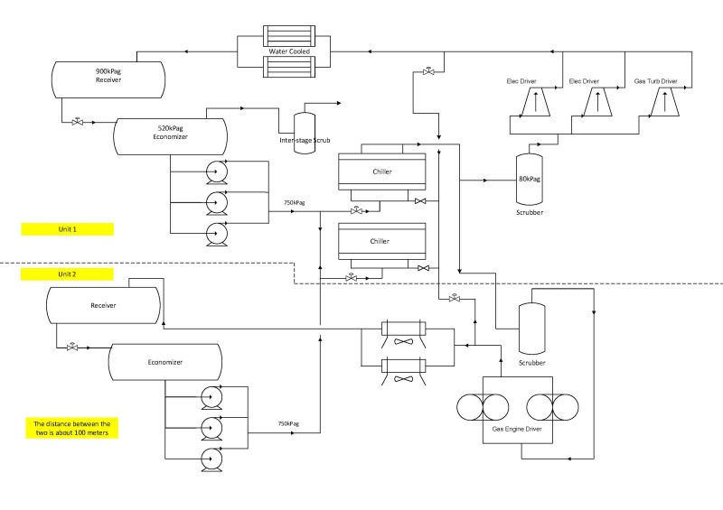

RE: Two process refrigeration systems working together controls?
Hello,
I've tried to attach drawing, hope it works.
Pipe sizes;
24" suction
6" C3-liquid
4" hot-gas
Presume the economiser on the new screw machines is working with flash gas routed / shared with the existing interstage scrubber.
Normally, there is a hot gas bypass around the condensor to maintain a constant pressure on the receiver - this should be there for both trains - but, in this case, if you have this as a common overhead pressure equalising line between the 2 receivers, that will make things easier to control. In that case, a level balancing line between the 2 receivers would be all this required to keep receiver levels equal. For this to work, the new air cooler propane exit temp should be the same as that for the existing water cooled unit. You havent stated what the pressure is fore the new receiver ??
Yes to your first statement. I was still drawing it up. There will be no balancing line between the two receivers, nor a over head line.

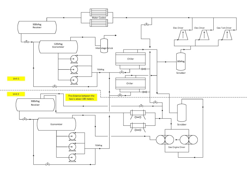

You've now added the hot gas bypass around the condensor on the new train, but there isnt one on the existing train? - thats a pity since you'd save some compression power by subcooling with water since you wouldnt need to generate as much subcooling through the economiser.
Agreed, you could run one train's compressor on normal suction presure control, while the other operates on fixed flow cascaded by low set suction pressure control. Can see some complications on how you would split the duties between the existing and new pump sets. No details given on the process side duty at the 2 chillers.
There is no hot gas BP around the CW condenser, or will be. On thing I have found out is our new receiver pressure will be 1300-1400 kPag (winter-summer).
For simplicity I only put down two chillers. The duty in the existing system is 4500KW @-15, which does fluctuate in the summer and winter. The new addition it will
change to 10000KW @-25.
If your new receiver pressure is 1300-1400kpag, then it is critical to get the same temp on subcooled propane to the pumps on both existing and new trains, else you'll have vapor breakout where the 2 streams mix before getting into the chillers.
As you said, from what you've disclosed so far, there is still an operational risk of unequal levels in the 2 receivers - this may have some effect on how the pumps share out the propane feed to the 2 chillers for the case when one receiver level has dropped low - this would occur due to the low set LC override at the receiver on to pump flow controls. Essentially, when one receiver level has dropped low, you could have the entire 10MW cooling load appearing on the other receiver / pump set.
