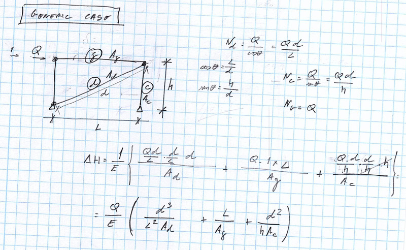

And here's the derivation for the general case using the virtual work principle:

Here's what I'm getting. I think avscorreia has an incorrect last term (d^2/h instead of h^3/L^2). What I have is a combination of jayrod's equation (considers brace and girder) and Istructeuk's equation (considers brace and column). Whether or not the girder influences anything is dependent on where you apply your lateral load and where you are looking at deflection. The load AND deflection have to occur away from the brace for the girder to contribute. When the load or deflection is at the brace, I get what Istructeuk had. I guess jarod's equation assumes an axially rigid column.
RE: Braced Frame Hand Analysis
You're absolutely right. That last term seemed odd... The mistake is in the value of the axial force in the column. I used Q/sin(theta) but is, in fact, Q/cos(theta)*sin(theta) = Q*tan(theta) = Q*H/L.
Sorry. My bad.
