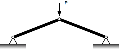

Hi everyone.I need to do the project about steel dome structures.I read some paper and searched in the websites.I found that the snap-through buckling is common failure in shallow dome, but I don't understand snap-through buckling.Please explain what is snap-through buckling and why it is common failure in shallow dome to me.Thank you.

For a fundamental understanding, I like the classic example of a system composed of two axially loaded bars loaded at the apex. While the apex remains above the horizontal, the compression in the bars resists buckling and the system is stable. As soon as the the apex drops a hair beneath the horizontal, however, the compression in the bars actually encourages buckling which takes place rapidly (the snap). The system eventually becomes stable again as the apex drops further and the bars go into tension. For most practical situations, however, the amount of displacement involved represents failure of the system.

This is the load/displacement curve for such a system under a displacement controlled testing setup. The dotted red line speaks to dik's point.

Axial compressive load reduces the length of the members in compression, causing the angle of the truss to get shallower. The shallower angle results in larger axial forces. If the load-displacement curve diverges, the structure isn't stable until the apex "snaps-through" and puts the members in tension.
