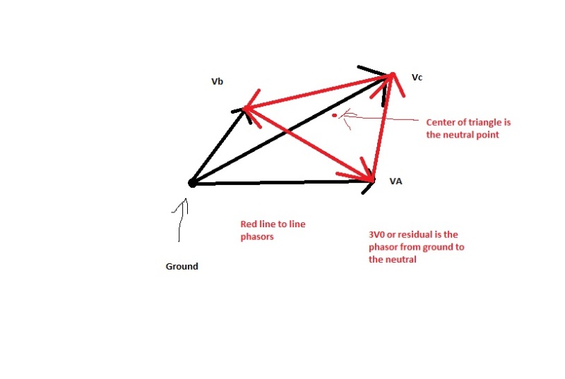

1, How are your VTs connected? The relay calculates the residual or 3V0 by adding up all the phases and referencing them to ground.
2. Anything that draws zero sequence components will cause line to neutral voltages to drift from ground on not solidly grounded systems. Ground faults, unbalanced load, untransposed lines.

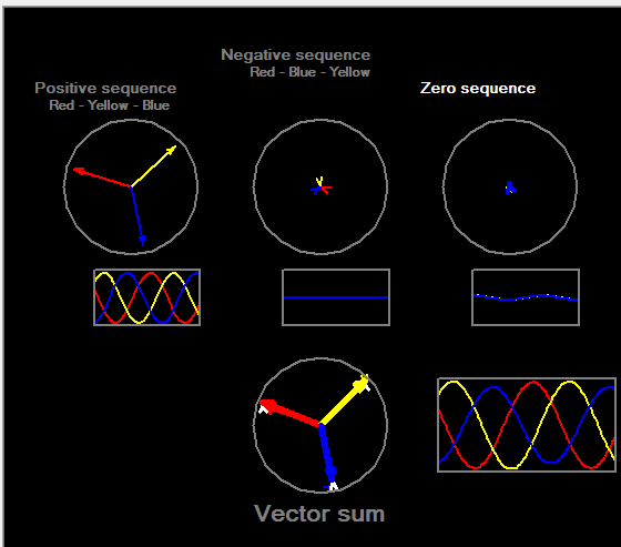

If you want an intuitive understanding use this tool I have linked at the bottom of this page. (http://powerprotection.wikia.com/wiki/Symmetrical_...) - "FREE Power Quality Teaching Toy by Alex McEachern of Power Standards Lab". It is a tool that lets you look at the phasors with varying magnitudes and angles of zero, negative, and positive sequence components. If you play with the zero sequence slider, you will see that it affects all the phase phasors equally. (that is the definition of zero sequence). The result is that it basically shifts your voltages off center, or off from ground. The neutral point will be the center of the triangle formed by your line to line values. The relay measures ground to this neutral point. I really recommend the tool though because it is one thing to be able to use the matrices to go from phasor to sequence values or vice versa but to get good feel is even better.
GIF of varying amounts of zero sequence.

The VT's measures Phase to Ground Voltages. I need to measure Neutral to ground Voltages (Vn). How is the neutral point derived/calculated by the relays?
