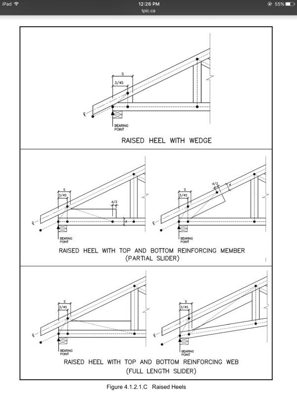

Also, I was under the impression that Method of Joints and Method of Sections was applicable to any type of Truss configuration, traditional or not, provided the requirement of each method was respected.

3) The Truss Plate Institute's design standard provides "fictitious heel joint" models that the truss industry uses to restore triangulation to heel configurations like this. You may want yo take a similar approach.
4) 1673# is the "right" answer in this case and will be valid once the heel joint issues are resolved. In physical terms, that probably means adding a slider to the joint. With a fictitious heel joint model in play, the method of joints should produce the same result.

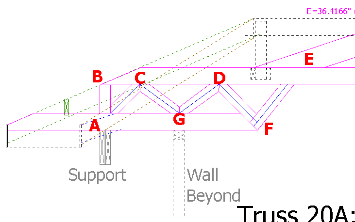

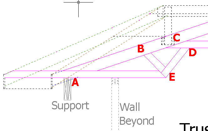

I would appreciate if you would also take a glance at the truss over the bay window and point out anything that might bother you. Your insight has proven to be most valuable and appreciated.
1st Consideration
Alternate

The two trusses in your latest post both seem pretty sketchy to me. They both have pinch points where there will essentially be no true truss action and only chord bending. I'd recommmend:
1) additional truss support.
2) more workable coffer/roof lines.
3) top chord bearing trusses if they work.
4) dealing with the more complex areas using hand framing.

1. A full height ceiling was desired in the bay window area negating the additional support possibility.
2. Not quite sure what is meant with this comment. The roof slope is set and the coffer ceiling is set.
3. The “1st Consideration” Truss can easily be changed to a true TopC bearing truss. This might be better because the compressive strength parallel the grain is somewhere around 2.5 greater than perpendicular to the grain. Granted the roof slope needs to be considered in the capacity calculations.
If a TopC bearing truss is utilized how are the horizontal forces in member AC picked up?
4. Again, not quite sure which areas you are referring to. I venture a guess you mean the AED section.

In the bay window trusses, the A joints aren't the problem. It's joints C & E in the first and second sketches respectively. High chord bending stresses at those locations.

That last truss (last post) over the bay window is really an awful abortion. Once you have resolved what you want to do (can do) with the typical truss we’ve been discussing, why wouldn’t you put the header in the bay window opening back at the main wall line, and then use a typical truss over the bay window? Then you stick frame the bay window roof and an interior soffit from the header out to the window, and call it a day. This would also put the main roof reaction back at the main wall line where is can be easily handled instead of out on the bay window cantilever. If you look back at my first post (12NOV16, 04:05) and read btwn. the lines, it pretty much encompasses everything that’s been said since then; although the other guys have certainly added a lot of detailed flesh to the bones. BA’s last post offers another way to skin the cat on the typical truss. Koot has offered some really good sketches and comments on how things actually work. RE: my first post, the last sentence; I was going to suggest two side pls./gussets (.75" plywd.) to cover the area A, B, B + .5, J, A, with BA’s web member B + .5, J. This would resolve the loose heel issue, but probably not as nicely/cleanly as BA’s scheme. It seems to me you have to slow down a bit, really read and think about the ideas presented to you, sometimes read btwn. the lines a bit also. Quit fighting the obvious, and making things difficult/complicated for yourself. You are kinda trying to reinvent the square wheel, which didn’t work so good the first time it was tried.

Indirectly, sort of. See the snip below from the TPIC doc which refers to the slider conditions. In my opinion, it describes delivering the chord force over the length of the slider, albeit never perfectly uniformly.
