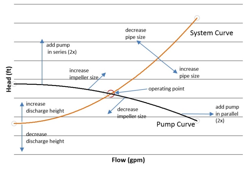

RE: Pump Margin Question
As mentioned earlier, a particular pump with certain impeller will operate on the intersection of the pump curve and system curve. You can change the operating point by either changing the pump or the system.
Change the pump curve by changing impeller, speed or adding pump.
Change the system curve by increasing pipe diameter, removing fittings, or lowering discharge height.
To quantify the changes see pump affinity laws.
I always prefer to size to the right of the BEP and select the impeller in the middle of the available sizes. When sizing, intuition says to add safety factor on to the head, but in reality, safety factor should be put on available power.

SandCounter : I would suggest it is better to select slightly left of BEP so any increase in flow doesn't run further out on the HQ curve.
In my experience, it is flow that is the stated requirement when designing a system. Head may be specified, but it is a necessary evil. I've never seen a centrifugal pump application where head was tghe objective and flow was the byproduct.
Usually there ends up being some design compromises in the final as-built system. Whether it's routing pipe around obstructions, added fittings, or generally inefficient routing, this all adds head. Once you have the system built and discover that your pump won't make the flow, if you've designed to the left of BEP, it's expensive to change the pump and changing impeller diametrr has little effect on flow. However, if something crazy happens and you actually have less restriction and the pump has a tendency to run out, you can easily throttle a valve or add an orifice.
Another advantage to designing to the right of BEP is that the pump curve is much steeper so change in head has less effect on the flow. On the left side of BEP, the shallow slope of the curve means any bit of unexpected head will yield severe change in flow.

Artist, below I respond to your numbered comments. Our differences probably represent differences in both experience and design philosophy.
1. Head is an integral part, yes, but I have never seen it as the objective. It is an effect of flow.
2. In my experience - head is understated, but it shouldn't matter if you put your safety factor on the available power rather than the head.
3. I have successfully designed this way for systems with single and multiple pumps in excess of 5000 HP and have applied orifice plates or discharge baffles to control over capacity when the installed system deviated from the plans or pump was repurposed from another system (which is the majority of my experience).
4. Can you give an example of a centrifugal pump that does not follow a quadratic curve that goes from high head/low flow to low head/high flow? This would be unique in my experience.
5. -
6.I'm talking just to the right. If you're still on manufacturer's curve, and not extrapolating, you should be fine. Of course you check NPSH, but you would do that anyway.
7. This is where we probably have the greatest difference. Getting a hold of real "knowns" including actual static lift, viscosity, actual pipe length, fitting count, and sometimes even SG in the 5 minutes to a half an hour I normally have to select a pump is a pipe dream. Designing to the right of BEP along with some educated guesses has helped me to consistently select for robust systems which have rarely needed rework, and when they have, its limited to impellers or orifices. Always have a plan B.
I might note also, that selecting a pump per Lilliput1's comment, design for head + 15% will put the actual operating point to the right of BEP so long as "design for" means for best efficiency.
SandCounter,
Guess we could discuss this back and forth for ever point by point and not really achieve all that much at the end of the day, however, my initial response was really to highlight for anyone reading this post that there was an alternate argument to what is "correct" or "best" selection - a second opinion.
Just a couple of points on your reply, the curve you posted earlier I would think is fairly typical of most pumps, it shows a fairly constant rise from run-out upto CV not much steeper either side of BEP (wherever it might be on that sketch)and secondly, throttling large pumps wastes enormous amounts of energy and not something I would ever recommend other than short term giving time to evaluate an over flow or head installation.
