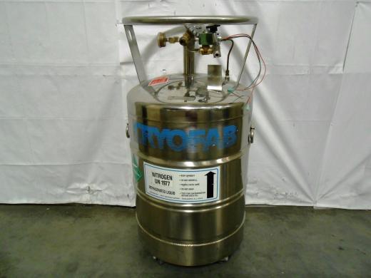

Here are 2 tanks I am considering purchasing; they are both LN2 dewars but they already have the plumbing needed to convert to LNG.
1.) Liquid Nitrogen Dewar, 25 liter, Taylor-Wharton brand, Model 25 LD. Nice used condition. No damage. Comes with plywood dog house shown, and roll around stand. Shipping depends on whether or not buyer wants the plywood box. So for now, it's shown as Local Pickup. Will Ship. Thanks for looking.
2.) This CFI Cryofab Liquid Nitrogen UN 1977 Dewar Non-Magnetic 11/99 appears to be in fair cosmetic condition with signs of wear and previous use.
I really lack the knowledge and equipment to test this piece properly and so it is being sold as-is.
Unpacked dims are 20*20*41.

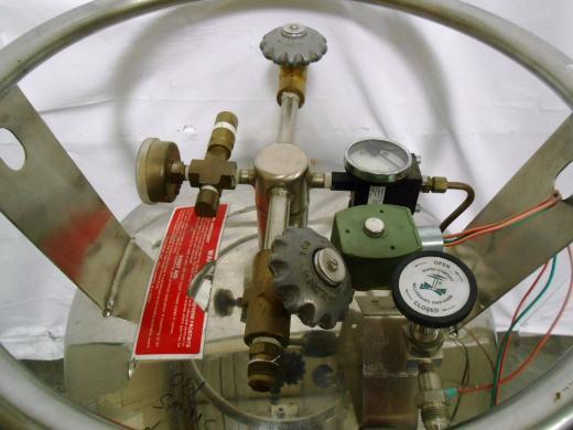

I attached 2 pdf files with the specs for the fill and vent valve. I've also included pictures of the tanks and valves. Here is the website:
Link
The more I research this the more I realize it is definitely possible. The main requirement is to get a LN2 tank that already has fittings, valves, and gauges on it. They are a little harder to find but they are definitely out there. I will hopefully be purchasing a tank this week. I can then know if I need my fill/vent valves to be in english or metric; both are available from Macro Tech.
Thank you all again for your help, it took me longer to get these specs up here so I apologize for the delay. I will definitely give updates of my progress and take lots of pics to show what I am doing. I'm sure I'll have some other questions.

voltech,
I'm not qualified to say whether these second hand units are good enough for your use, but the key to me is doing something that means you aren't leaking explosive gas into a confined space. A little bit of N2, whilst it can be lethal in certain places if it pushes all the O2 out, won't explode - methane can.
Hence the design pressure of those containers is critical as any rise above the design pressure requires venting. If this pressure is quite low, then it won't take much of a rise in temperature to start venting when you're transporting or storing it as opposed to using the LNG.
Clearly all the connections and piping need to be suitable for cryogenic temperatures and insulated for personnel protection and to avoid lots of ice on small bore piping.
Be careful.

I've been researching pipes/valves that are suitable for cryogenic liquids. From what I can tell, the pipes/fittings/valves/gauges on that cryofab tank are designed to work with LN2, so they should also work with LNG. My plan is to testablish the tank by filling it with LN2 and checking for leaks, and monitoring the boil off gas rate to make sure it's in spec. I will also do tests in the truck to see how the motion affects the boil off rate. If everything is in spec and no leaks are detected, I can drain the LN2, leaving only N2 gas inside which will be safe for filling with LNG.
One possibility for the vent gas is to run the vent tube to the engines intake manifold. Since I'm only transporting a small amount of LNG it shouldn't be producing a lot of gas, so it shouldn't choke off the engine. I wish I had a diesel-powered truck because the methane would actually increase the MPG. I'm trying to do some calculations to know roughly how much gas will be vented and if it will affect engine performance.
