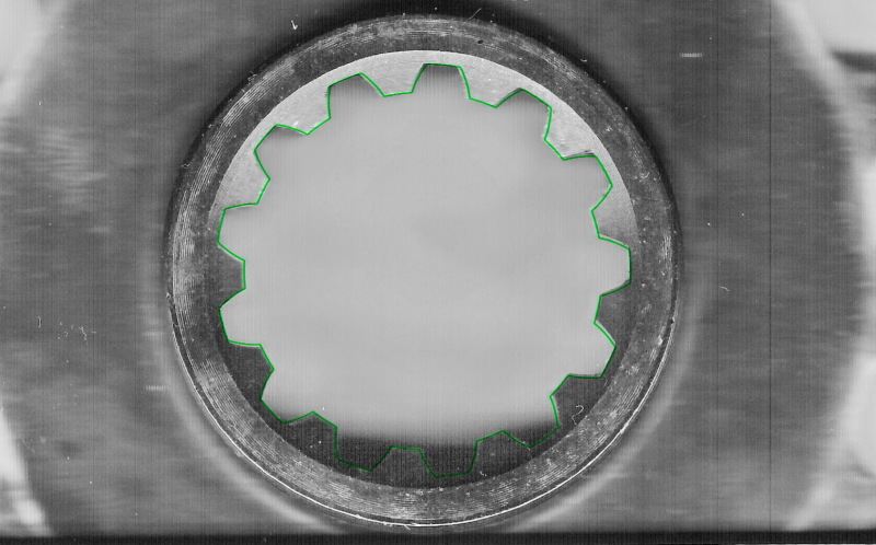

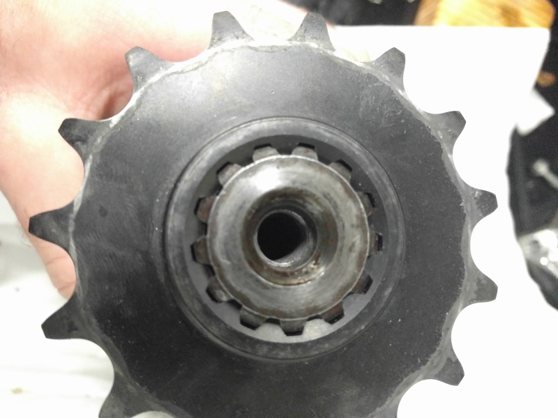

I'm trying to identify the spline that comes on a Honda CBR600RR transmission output shaft in order to produce a custom tooth sprocket for my school's FSAE team.
I have both the transmission output shaft and a new sprocket to measure, but I don't have access to measurement pins or any sort of CMM or shadowgraph to use.
It appears to be a flat root, side fit with an involute curved tooth. There are 13 teeth. Some rough measurements with a digital caliper of the output shaft gave me a major diameter of 1.160in and a minor diameter of 0.980in. However measuring across an odd diameter spline was very awkward to get the minor dia.
I've uploaded a scan of the sprocket and based on some sketches I overlaid in Solidworks I was able to come up with some measurements that are very close to an ANSI B92.1 12/24 30deg spline. However, if I switch to the metric equivalent of a B92.2M with 2.11667m, the minor diameter lines up slightly better. But I don't think metric modules come in anything other than 1.75, 2, 2.5 etc, correct?
I can't find much information for JIS splines, however I don't think there is an appropriate module available that would match my spline.
Can anyone lend a hand? Ultimately I'd love to have a dxf or something to get the custom sprocket wire EDM'd.

RE: Identifying a spline
Most Japanese automotive splines are as per JIS B1603-1995.
The spline which your image shows looks more like a Major Diameter Fit spline with a 20deg generating pressure angle. The standard above doesn't cover this.
There is another Japanese automotive spline that is now obsolete but still used on many parts. Parts like CV Joints, sprockets, timing gears, etc.
The standard is JIS-D-2001 and is unique as it utilises a 20deg generating pressure angle. All other involute splines are either 30deg or 45deg.
This standard also allows for a MDF (major diameter fit) to be used. You can confirm this by measuring the clearance between the major diameters of the assembled parts. If it looks like there is very little clearance (or sometimes none at all) then it's a MDF spline.
So for 13 teeth with a MDF, here are the measurements............they seem very close to yours.
Ext maj diam - 29.91 - 29.98mm
Ext min diam - 25.20mm
Int maj diam - 29.96 - 29.98mm
Int min diam - 26.00mm
BTL (base tangent length) over 3 teeth of the shaft should be close to 16.22mm.

Thank you everyone for the feedback. Unfortunately the school is closed today and I can't access the pieces to check the measurements you provided. I have a photo that I took of the pieces mated together that shows a large clearance between the major diameters, which is what initially let me to believe it was a side fit. I will measure this clearance as soon as I can get access again.
Not being a MDF spline makes things a lot easier.
The next step to take is to measure the base pitch.
For this 2 base-tangent-length measurements are required.
In this case; the BTL across 2 teeth & 3 teeth are needed, see example below.
Also, a 3rd measurement across 4 teeth might be helpful.
Once the BP is known, then we can work out the pitch & pressure angle.
It's increasingly looking like it's a JIS-D-2001.
We'll need to confirm some of the hub's dimensions.
Your idea of scanning the part is an excellent idea as it gives a very good representation of the scale.
When working with odd numbers of teeth; try using a reference diameter to measure off. See the first image below. Note how I've estimated the size of the boss and then measured the radii that reference the diameters we need. This works quite well assuming that the spline profile and boss have been machined on-centre.
The second images shows the JIS profile overlayed (bright green line) on your scanned image. It certainly is very close.
Your spline is as per JIS-D-2001.
The type of fit (either class A,B,C or D) is controlled by the shaft's dimensions.
Data below is taken directly from the Standard.
2 module, 20deg Pressure Angle
Flat Root, Side Fit
Z = 13
Hub Dimensions
Maj diam = 30.60
Min diam = 26.00
MBP 4.00mm = 21.94 - 22.02
Shaft Dimensions
Class A
Maj diam = 29.60
Min diam = 25.20
MOP 3.60mm = 32.87 - 32.95
BTL k3 = 16.21 - 16.25

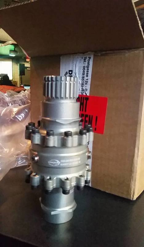

We are upgrading our rear diff this year to a Drexlar unit, saving us a lot of weight and helping us put our power down a lot better.

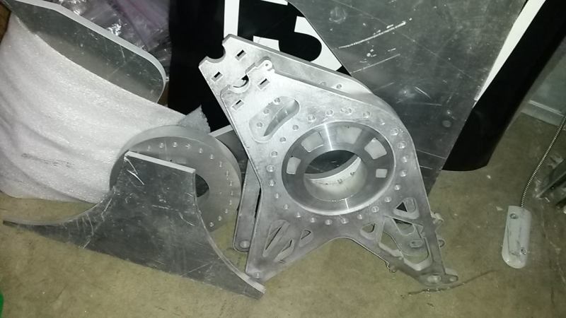

We just recently started working on our new diff and engine mounting brackets, cut on the water jet at school here. They still have a bunch more work to do.
