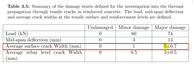

https://www.era.lib.ed.ac.uk/handle/1842/6229
There's a pdf download link on this page for the thesis. His 'major damage' crack width was in the order of 5mm +/- 0.7mm and showed no difference in temperature inside the concrete. There could be convective effects that weren't captured, but I think this probably should show that minor cracks aren't significant risks to fire protection.

Quote (TLHS)
Yep, that's the one...and he is one of the co-authors of the ASCE paper too. I misread the 'major damage' crack width of 5 mm +/- 0.7mm - I read it as 0.7 mm total crack width in error.
5mm is a BIG crack width:
Quote (Adam Ervine, PhD Dissertation: "Damaged Reinforced Concrete Structures in Fire")
Thanks TLHS.
