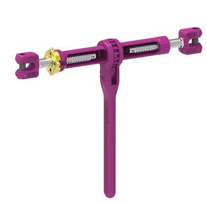

Hello,
Does anyone know of something that's similar to a turnbuckle, but is use for a lifting chain...?
This is the closest I can come to, but it's not made for lifting.. https://www.mcmaster.com/#2967T6
RE: Chain accessories options...
You're not going to find a lift-rated chain ratchet. You wouldn't want to use one for lifting anyways- your lift would be VERY slow.
What is the real problem you are trying to solve?
Thanks RolMec for your suggestion, but what jgKRI said is correct, I asked the RUD ppl already, its state on their catalog that those are not made for lifting.
@jgKRI, I'm using lifting chains to lift a counterweight. I'm just trying to adjust the chain without removing links. There's chain/rope/cable that will be attach, and they need to be able to adjust individually in order to balance the "platform".

The only option I can see is standard shackles, removed and re-installed on the correct link to balance your lift.

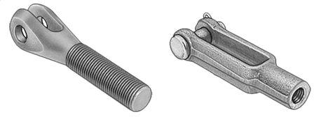

Instead of adjusting the chain can you just adjust its mounting point height? You could use something like these clevis rod ends in combination with a threaded rod or nut to adjust the height and then pin the chain to it. It wouldn't be able to be adjusted under load though since you need to disconnect the chain.

Its a one time balance, that's how I see it too.. I was hoping for something safe that's available..
Our company has been using this setup for years, but it's always been done on a smaller scale and the adjustment were already difficult to do.. but now they're 5/8" size chains, so we have to make the mounting point insanely safe. The seniors engineers isn't too comfortable with threads, tension, and movements... The good thing is that this load will be moving a bit "slow".
