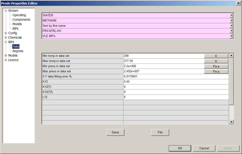

I have water solubility measurements in vapor for methane-water, ethane-water, propane-water etc. for each measurement I know
Temperature Pressure Water content in vapor phase (Y)
282 K 10 Bar.a 0.0012
I wish to calculate the BIPs for different models (such as Peng Robinson, Soave Redlick Kowng etc.) and compare results (vapor-liquid equilibria),
my free copy of Prode Properties includes the procedure however I do not know how to enter X1 and Y1 (as I know only Y1),
is that possible with the free copy of Prode ?

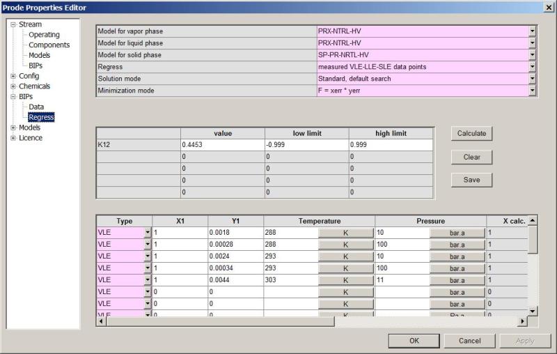

probably you can solve with any simulator but the free version of Prode allows that at reduced cost smile
set water as first component, enter your Y values and set X values to 1
here below the two steps (I have included some points from water-methane tables)
by the way you can then simply solve a series of flash operations at specified T,P
to verify accuracy of different models,
see the procedure for SLE data regression discussed in operating manual
http://www.prode.com/docs/pppman.pdf
data regression in free version is limited to two components only
