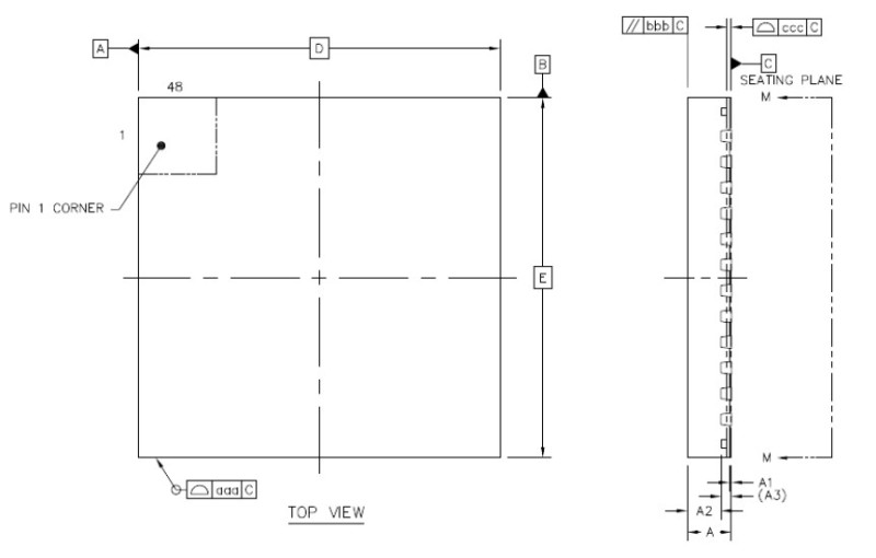

Few questions arose when I saw an IC package outline drawing last week, pls ref to the attached for details, my questions:
Question 1: Can we delete the datum reference C from profile FCF?
Question 2: Profile tolerance value will be less than the size tolerance, am I right?
Thanks for your valuable comments.

Lots of issues on that print...
Datum feature C isn't labeled; that's the first problem. But assuming it's the main flat face, then it's OK to leave datum C reference in the profile callout.
Since that profile is 2X, the profile itself controls the size (height and width), so there is no reason to have the profile be less than the size tolerance (the size is basic).
Several other things (such as the composite position being changed to 2 single segments with 2 position symbols), but I hope that helps for your original questions.

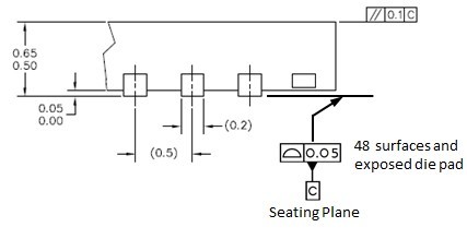

RE: Coplanarity application
My bad -- I just now scrolled to the second page. So yes, datum C is fine. But the profile tolerance value might still be OK, because the dimension of 0.00 to 0.05 looks to be tagged to a different level. And it's not really a feature of size, so there's no Rule #1.

I agree with John-Pauls' assessment. Did I miss something - what dimensions controls the distance from "Datum C" face "up" to the 48 coplaner surfaces?

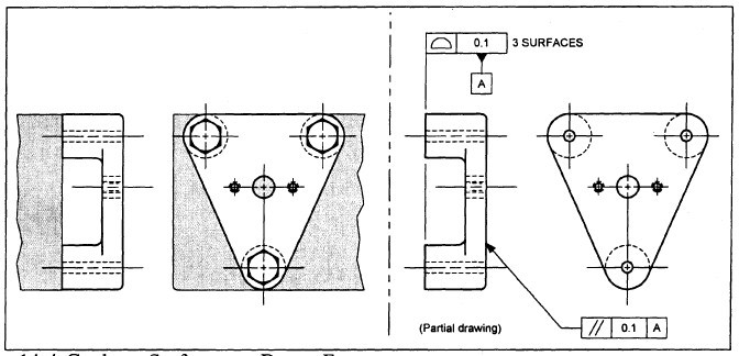

There are 3 pages on my attachment, page 3 mentioned the coplanar surface is composed of 64 lead surfaces and the exposed die pad, a profile control will be used to treat them as a single surface, in this type of application, the profile control is a form control and does not use datum references, example is shown below. I still can’t understand “datum C is fine” here, would you please have more detailed interpretation on it.
I would aldo replace profile to C in the main view with perpendicularity to C for datum feature A side and with perpendicularity to C primary and A secondary for datum feature B side.
Yes, SeasonLee, your proposed change makes MUCH more sense. The original use of a phantom line didn't really make sense, since there is no nominal around which to make it unilateral. I guess that's why I didn't even understand what was being pointed to.
Your second question seems to bring up a good point too. If the profile tolerance is really utilized to that full 0.08, it will make some of the surfaces sit below the other surfaces, which is exactly what you don't want. Sure, you can make the profile tolerance less than 0.05, but make sure that they can still hold that.
Greenimi -- What you suggest wouldn't be the same thing. The current use of profile on those 4 edges (2X for each profile) controls the form, orientation, location, and size of the full perimeter. It's essentially an "all around" profile (which would have been an easier way to show it).
Perpendicularity would only control form and orientation, and require the basic dims to be changed to toleranced dims.

I feel like the relationship between C versus A and C versus A and B is orientation only. In the shown configuration, C being primary then the secondary is to be oriented to C and not located.
I would say if you cannot say for sure/ you cannot tell how far apart is C from A and/or from B respectively, then the correct callout is orientation and not location. Same design intent, but bad “grammar” in GDT language.

JP, Thanks for your inputs again. If I were the designer I will delete the datum reference C from profile FCF, and reduce the profile tolerance value to 0.05 at least in this particular case, the revised sketch looks like it below.

I have been following this thread. I have ask, was any consideration given designating the "top" surface as Datum C and have the tips of the (48) pins individually profile-controlled "parallel" to the top. This would eliminate the need to use the coplanar control.
Greenimi, I presume you're talking about the first picture in that 3-page drawing. In that case, the profile tolerances fall under the rule of "simultaneous requirements." (Paragraph 4.19 of Y14.5)
So the four sides are not just oriented, but also distanced apart. IOW, the max width of the square is 7.1 mm, and the min could be 6.9 mm.

Not part of the OP's original two questions but the top line of the composite profile (PLTZF) needs to be changed to C then A then B for the second line to be meaningful.
