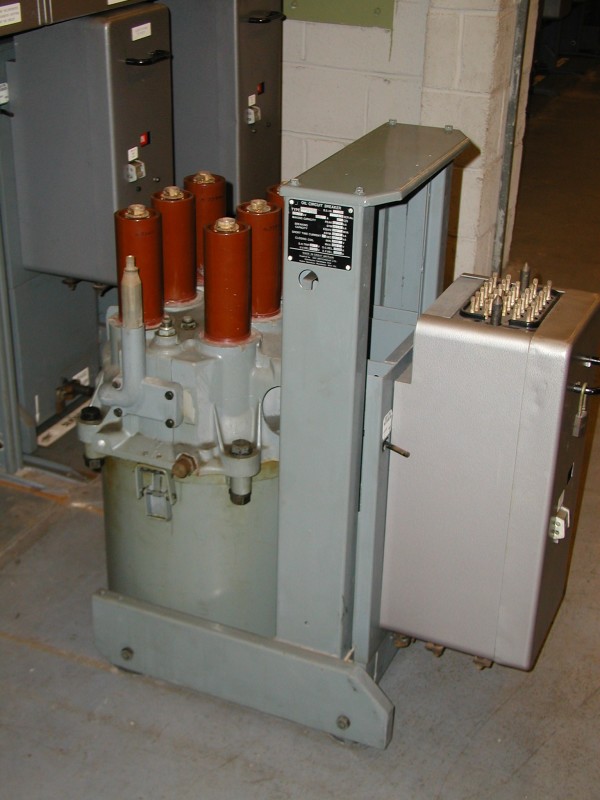

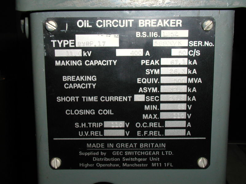

RE: Legacy 11kV switchgear GEC type BVRP17
Well we can put that shortfall to rights!
Doesn't look much (any?) different to the 250MVA breaker, at least not externally.
Thanks for the photos Scotty, my life is now complete bigsmile.
As you say, looks exactly like the 250MVA gear.
P.S. I wasn't doubting you, just never seen such a beast in the wild!
