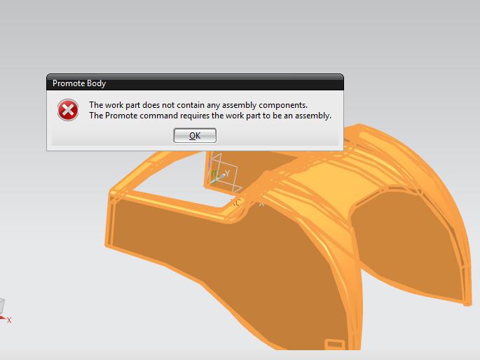

It looks like I do need to create an assembly file (for the machined part), either using Wave or Promote Body.........
Am I on the right path?
CAD 2015
RE: Associative Casting/Machining files
Yes, you can only Promote a body into an Assembly by selecting a Body (Solid or Surface) in one of the Components of that Assembly. Please keep in mind, that once you've created the Promotion, that unlike WAVE-linked bodies, you must keep the Assembly(s), even if you have a series of Promoted Bodies going from one Assembly level to another, maintaining the Assemblies is necessary. With WAVE-linked Bodies, while the only practical mechanism to get access to the part models from which WAVE-linked objects can be identified, once the links are created, the Assembly used in the process is not absolutely necessary that that be kept around. Now it's recommended that you do keep the Assemblies, not because without them the WAVE-links will fail, just that if you need to add more objects to a linked scheme, it's easier to do if the original Assemblies are around to provide the environment to do so.

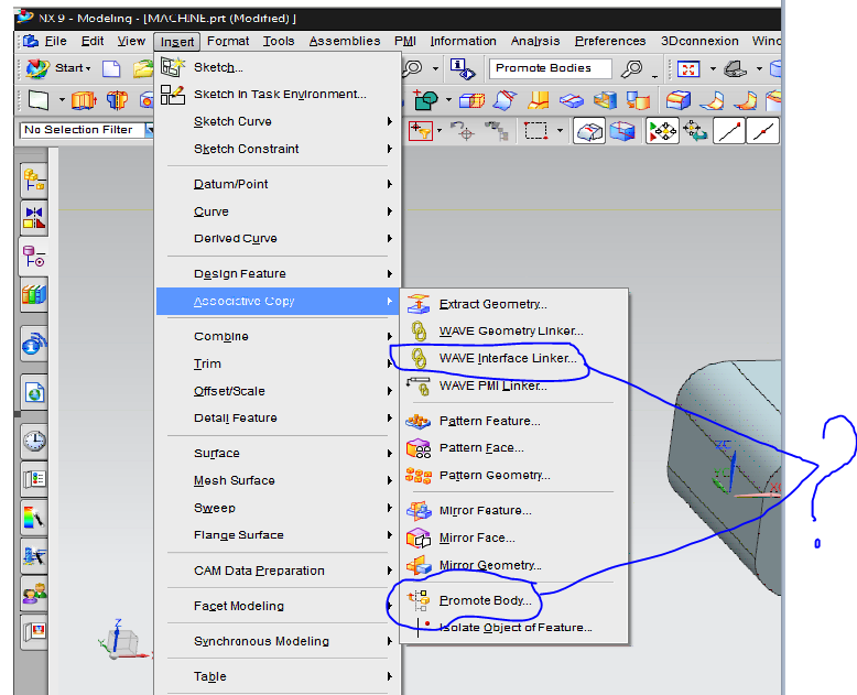

Another question for Mr. Baker:
1) When should we use "Promote Body" and when "WAVE Geometry Linker"?
2) What makes one better than the other, in an given environment?
CAD 2015
I've already commented about the fact that for the task that you're trying to perform, the 'Promotions' are generally the best approach. WAVE is best when you wish to share or 'link' topology of one model with another. For example, if you wish to align the holes on a frame with the holes of a bracket, I would use WAVE to link the centers of the holes in the bracket using the points to locate the holes in the frame. However, in the case of where you're in essence 'replacing ' one manifestation of a model with another, such as to define the manufacturing steps, like the machining of an as-cast or as-forged part so that it represents the as-finish machined part, I would use Promotions because first you need to deal with the complete body and second, at each level the parent part is no longer needed, only the child which is then modified by adding additional modeling features.
Just remember, with promotions you get a copy of the entire body, there are no other options. While with WAVE linking you can pick and choose the type and amount of 'objects' that you wish to share or link into another model.
