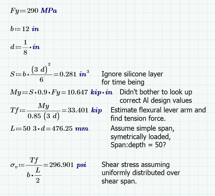

Two 1/8" aluminum plates are glued together with a 1/8" thick silicone.
When computing deflection should I conceder it as a combined shape or laminated ?

Probably composite, paying homage to the strength and shear stiffness of the silicone layer. Treating it as non-composite would give you a simple upper bound estimate of course. But, then, in the real world, the loss of partially composite action is indicative of failure. Kinda depends on what you need from your answer.

Since all three layers have the same thickness, and silicon is way more elastic than aluminum, wouldn't it be accurate to assume that the top and bottom (aluminum) plates shall deflect independently even if there is no failure ?

...at least in my world, one 'laminates' in order to achieve 'composite' action, .... and the laminating connection must resist horizontal shears, that is the tendency of the individual laminates to slide past each other in the horizontal plane under loading, in order to be considered 'composite'. your 'way more elastic' connector won't accomplish compositeness.

In the cited document, the disparity in moduli is presented as justification for ignoring the core contribution to flexural stiffness. It is not presented as justification for treating the face plates as acting non-compositely. In fact, EQ 7.49a, by it's form, assumes 100% composite behavior.
Without running any numbers, I suspect that you'll have a high degree of composite behavior here as well. While the disparity in modulii is a couple orders of magnitude, the shear stresses are also usually a couple of orders of magnitude less than your flexural stresses so those effects tend to balance out. To assess the situation simply, try this:
1) calc flexural deflection assuming composite behavior in the face plates.
2) calc shear deflection in the core with standard VL/AG techniques.
3) compare one and two to get a sense for how much shear deformation of the core matters.

hokie66 is correct. Silicone can indeed be structural; however, it has significantly different moduli (any of them...take your pick) than a metal. In that context, I would not consider this a composite section, but one of independent layers that happen to be attached.

This is not about the properties of silicone rubber as an adhesive. Is more about the structural properties of silicone rubber compared to structural properties of aluminum. Even if the silicone rubber is "perfectly" bonded to each of the aluminum sheets, I see this problem resembling a (hypothetical) beam where the flanges are metal and the web is rubber. IMHO, the silicone rubber layer is essentially structurally "worthless"... the two aluminum sheets are two independent layers, per comments given by others.

I put some ballpark numbers to this assuming one would want to take the aluminum all the way to yield which is probable untrue. Lots of semi-valid approximations and no consideration for stiffness. It's fails but it's not like the shear stress is orders of magnitude out or anything compared to OP's allowables. Kinda depends on your expectation for the system. However, I'm used to working with silicone systems that give me ~20psi shear strength in SSG glazing applications.

In conclusion, I feel more confortable with independent action then with composite action.
