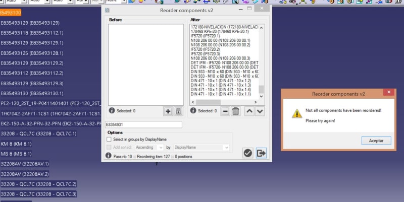

http://scripts4all.eu/smartsort/
It is doing exactly what you are after but much faster and more reliable way through Windows Automation.
Main Features:
- Works in Visualization mode or Design mode
- Perfect for large assemblies (no need to switch to Design mode)
- Constraint links are preserved
- No CUT & PASTE operations and no broken links
- No components renaming
- It uses CATIA native Graph tree reordering feature
Regards,Tesak

RE: Re-Order CATIA Tree
Any help will be appriciated.
Sub CATMain()
CATIA.SystemService.ExecuteProcessus("D:\00_CATia_tool\SmartSort.exe") 'file position
End Sub
Sub CATMain()
If CATIA.GetWorkbenchId = "Drw" And CATIA.GetWorkbenchId = "DrwBG" Then
MsgBox "Not for drawings.", , "Error"
End
End If
If Len(Dir("C:\Temp\")) = 0 Then
MkDir ("C:\Temp")
End If
runPath = Dir("C:\Temp\SmartSortLoc.txt")
If runPath <> "" Then
Open "C:\Temp\SmartSortLoc.txt" For Input As #1
Line Input #1, runPath
Close #1
End If
Check:
If Dir(runPath & "\") = "" Or runPath = "" Then
Here is the full version of the Reorder. The zip's password is 1234.
The minimum protection of the code inside is using an *.exe file.
Feel free to use it or not.
Good luck!
it is a great tool. well done.
uhm do you have that kind of tool of renaming every part number or instance name? or just deleting part number or instance name?
thanks
Here is my sorter that I created. It can sort based on Boeing detail number (which is what we do here mostly) or by instance name. I have also included the source file so you can add your own sorting algorithm (you just need to sort the values in the right box).
Here is an updated version of Reorder.
https://goo.gl/gvDi9D
It now manages the situations when instances' names are identical except the case (e.g. Part1(Part1.1) versus Part1(PART1.1)).
Please note that the tool is free of use commercially or not.
Any feedback (especially the negative ones) will be appreciated (you can find my email in the file properties).
Calin
