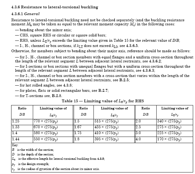

I have an edge beam with RHS section which is subjected to eccentric loading which creates torsion on the member. Is there any limit (According to EC) on the length of the members so that the LTB can be discounted? Or is there any limit on the h/b ratios?

I've seen h/b < 1.5 in the past but I'm at a loss to remember where.

For HSS sections you start having issues with LTB something around L=30m and high L/H ratios.I believe that I readed it on the AISC comments.

I have this handy little table from BS 5950. Depending where you are in Europe, The old BS approach can still be valid.
