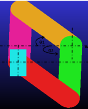

Hi ,
Please anyone can help me in how to make design variables of links dimensions on ADAMS VIEw modeling ???
i draw design points and there is a problem in defining how each link is varied from which end
it is a slider crank mechanism .

yes i saw this video several times but my case is different i have four links those links can be varied so i want to make DOE design of experiment to see how in each case the length affects the output displacement
