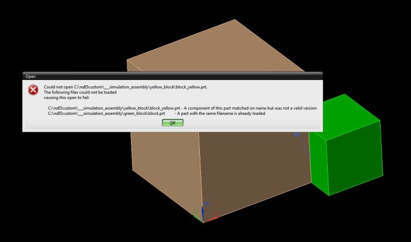

I tryed to simulate that and NX refuse see error.

a984928,
You have created two separate part files with the same name; this will create two part files with unique header information. NX recognizes them as separate parts and this is why you see the "not a valid version" message. To see the issue that CNSZU sees, try doing a save-as on one of the component parts (but do not rename the assembly during the save-as) or copy the component part at the OS level to a new folder and make a change to the copy. Which one opens in the assembly will depend on your load settings.
CNSZU,
NX will not load two parts with the same name into memory; it will not automatically give the files new names. I agree with petulf that cloning is probably the easiest solution.
