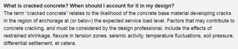

I've seen several definitions of uncracked concrete that name shrinkage restraint as a source of fastener compromising cracks. With that on the table, even a PT slab might not qualify as uncracked locally. I wish that they'd ditch the untracked option altogether so that we could just all play by the same rules. I feel more comfortable with uncracked when there is some redundancy and, by virtue of probability, not all of the fasteners will land in cracks. You situation would qualify in my opinion.

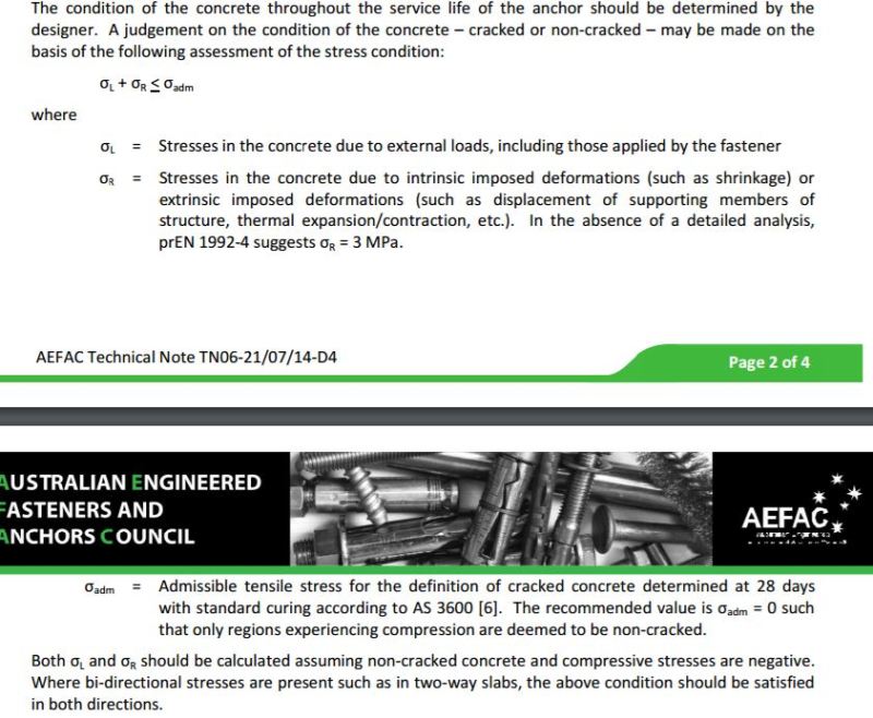

If shrinkage cracking were on the table, how could anyone reliably treat any concrete as uncracked? If that were the case, providing uncracked values would be straight up negligent.
RE: Cracked Versus Uncracked
I hear it. But from the perspective of the anchors, is a crack not a crack regardless of the cause? The clips below come from the following sources:
Is this actually written by practicing engineers? Seems that everything is cracked because it is not possible to say it is not.
Quote (XR250)
Unlikely. The links that I provided will take you to the sources for the snippets.
Quote (XR250)
Yeah, that's the short of it.
