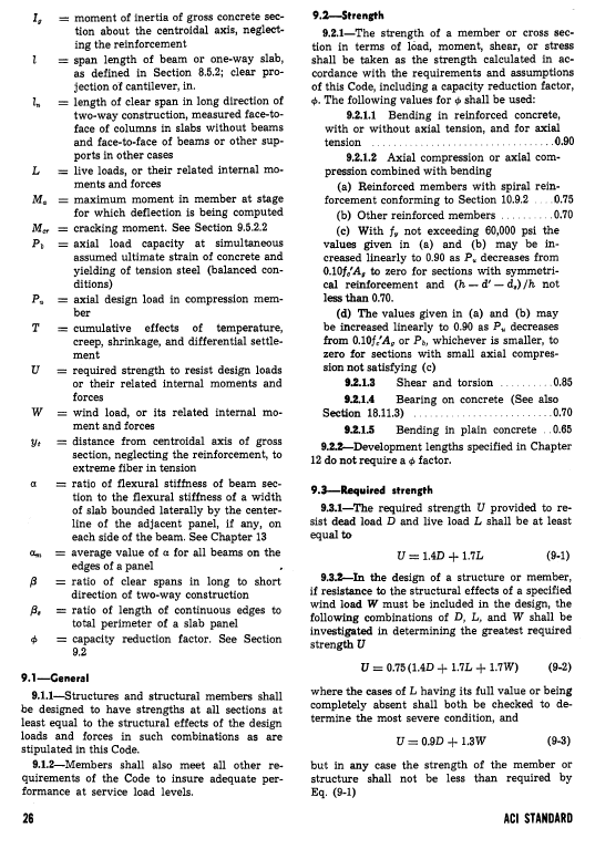

Here is a part extract of ACI 318-71, Section 9, with some load factors and φ factors:
ACI sells a USB thumb drive of all ACI 318 documents from 1908 to 2005 - at a cost of less than one copy of the current code! Link

I don't have a copy of ACI 318-71 but I do have a copy of ACI 318-63 which included both Working Stress Design (WSD) and Ultimate Strength Design (USD). The symbol Mu was included in USD but not WSD and was defined in Chapter 16 as ultimate resisting moment, so I would interpret the Flexicore value of Mu to be the ultimate moment capacity.
The attached PDF is taken from ACI 318-63.

You might do well to get (look at) copies of a couple Conc. Design textbooks from that era. Mu was the ultimate strength design moment, based on Ultimate Strength Design from that era, such as it was at that time. The 1.4D + 1.7L was right out of the ACI Code, as you can see above from Ingenuity’s attachment. There were also capacity reduction factors sprinkled throughout the design formulas. We didn’t factor loads up or use a phi (φ) value for Working Strength Design. But, most everyone was using Ult. Strength Design by the late 60's or early 70's, certainly the precasters were. The ACI-63 code had both WSD and USD and the ACI-71 (the next ed.) only had USD. Flexicore would have used Ultimate Strength Design for their planks as indicated by their 1.4D & 1.7L notation, and the moment they show as Mu is the ult. design moment, not a imminent failure moment, so I wouldn’t expect failure at 51 ft.-kips.

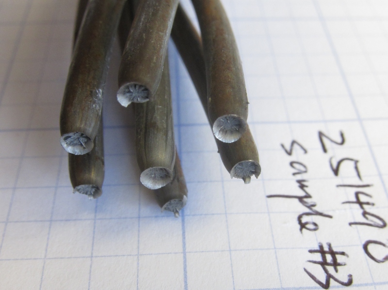

I agree, but those pesky smile precasters like to 'play' with their strand configurations (even mixing up diameters like 3/8", 7/16", 1/2" in the same plank), use 250 ksi vs 270 psi MUTS, change their stressing/jacking force etc.
For example, FLEXI-CORE have 7 different strand configurations for the same plank dimensions (above):
In extreme cases, we have undertaken invasive probing to determine strand diameter, # strands/spacing, clear cover, and even removed 5' long strand samples and had them tensile tested in a lab to determine grade. We take a 'stab' at the Pj and then calc the capacities by hand.
