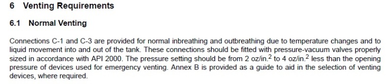

Which revision of API 12F are you referring to? Mine is 12th edition, effective date April 1, 2009.
Section 6.1 says - in addition to reference to API 2000 - "the pressure setting should be from 2 oz/in.2 to 4 oz/in.2 less than the opening pressure of devices used for emergency venting".
