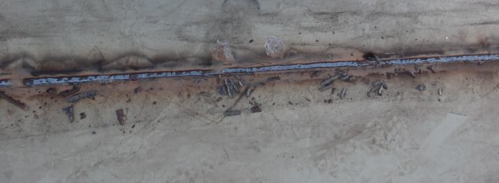

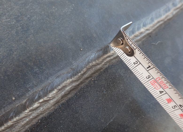

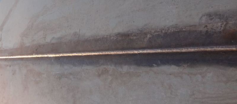

Dear Syahar1975
I worked as the welding engineer more than 10 years,and experience in storage tanks. that is a bed concept and habit for the welder to execute welding working as per his experience aside the WPS .
other reasons why the welder don't welding as per the WPS because the WPS is not very clear or out of practice. The welding engineer must familiar with not only the standard but also the welding operation.
like the circumstance in you question. when Bottom plate to bottom plate OR bottom plates to annular plates lap joint where the thickness is 8-10 mm,I recommend a welding sequence, firstly use the 4.0mm electrode,deposit a fillet size about 4mm in the corner of the lap joint,then use 3.2mm electrode deposit the upper and lower of the first layer to make the fillet size fulfill the requirement.
update some photos for you reference.
