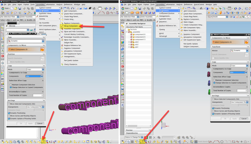

1 year ago I got laid off from my company, when that happened we were using NX6. I have been rehired now and we are using NX8.5 there was a command in NX 6 that allowed a user to pick a component in an assembly and copy and move it. I can now find that command in NX8,plus I do not remember the name of the command either. Doesn't anyone out there know what I am looking for?

I'm guessing you're looking for Move Component. It looks to be only on the Assemblies toolbar now, but you could customise the menu to add it back.
Attached image shows where to find (at least in my using of the default advanced role).
