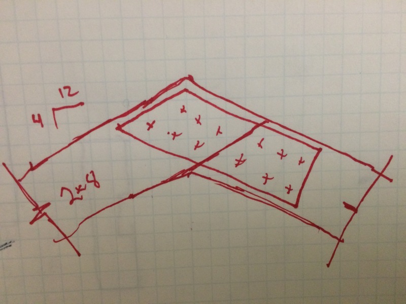

Got a job where they want a vaulted ceiling with no ridge beam. I designed 2x8 rafters with V- shaped plywood gussets. The span is only about 8.5 ft. The builder got a quote from a truss company and they are proposing what is attached.
Basically, using the nail plate to act as a moment connection at the peak. Seems a bit sketchy to me.
What do you think?

One could perhaps devise a more convincing version without compromising the intent. At the scale we're talking about, I'd happily stamp the detail below with 18 ga plate stock.
RE: Wood Truss
I agree. I'd also add a small strap over the top too.
Mike McCann, PE, SE (WA)

Original detail seems to have a lot of extra material not located where the maximum forces are...just an opinion from the woods...

There is one aspect of the gusset detail that I'm curious about. The reenteant corner at the tension side of the peak will cause a notch like stress concentration that would be the death of 2x material etc. Are tension side stress concentrations not an issue with plywood? I could see how the laminate/particulate nature of plywood might improve that aspect of behaviour but I've never seen anything in print to that effect. Not that I've looked especially hard.

Your a frickin Petroleum Engineer, why should I listen to you bigsmile Thanks for the input. I honestly did not spend much time optimizing the detail as the fee was really low on this one.
Quote (KootK)
My gut feel was that the laminated nature would negate the notch issue in a low stress application like this one anyway.

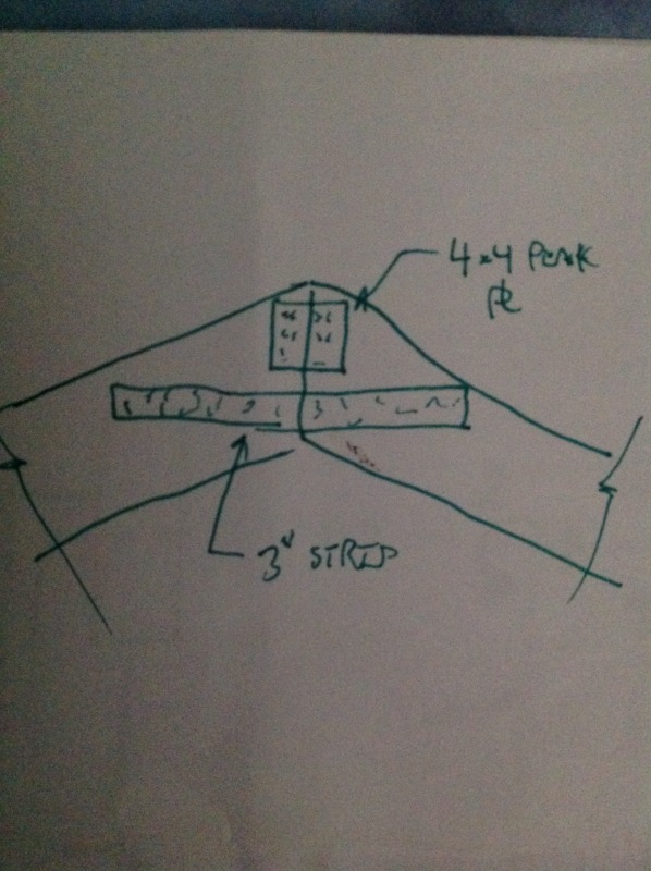

Here is an easier idea that i should be able to make work...
RE: Wood Truss
If you've already got it designed and detailed, I'd stick with what you've got. It's a good detail and I assume that you went 4' to use strips out of a common sheet. The sketch below shows an alternate option for both kinds of plate.

Yup, using a 4' sheet. I like yours.

I like KooTk's latest version, but I'm just a dumb Pet Eng so, never mind...

Quote (Kootk)
I guess we could even simplify your idea and just lap the suckers. Would change the dynamics of the fasteners however. My moment is only 360 ft-lbs (ASD) so it could be made to work. Might want to add some Elmers on top of that :>

I'd considered that too XR250. I was concerned that you builder might object to the plywood joints being offset across the peak. Although, it's not as though the ply is continuous across the peak anyhow.
