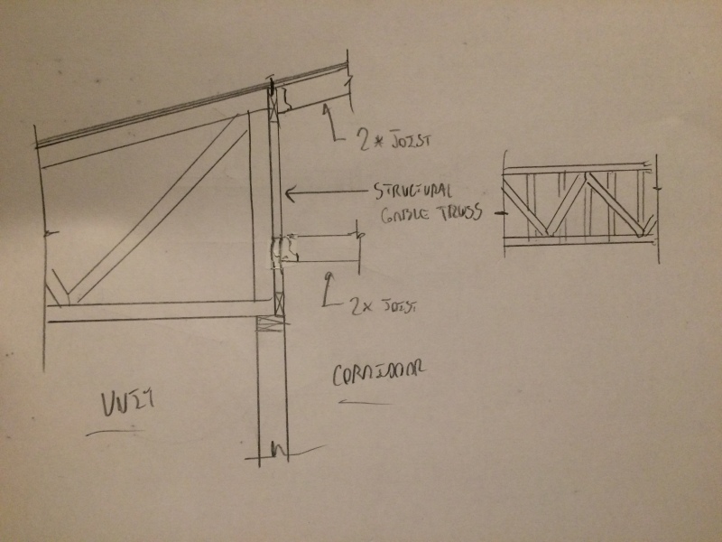

How do you get the diaphragm load to the top of the corridor wall? Top of corridor truss bearing is 10'-0". The ridge of the roof is 23'-5" high. The the heel height of the trusses at the corridor wall is about 13'-5" tall. How does the load in the roof diaphragm get to the top of the shear wall at 10'-0"?
Dubiously in most cases. In jurisdictions where they are very conscious of lateral design, they'll sometimes build shear wall panels to fit between the trusses, essentially turning the end of the truss into shear wall up to the roof deck. As you can imagine, builders love this.

We specify either the much loved shearwall elements as described by Kootk or the truss manufacturer provides diagonal truss blocks between the roof trusses to take the shear.

jdgengineer. I am not familiar with diagonal truss blocks between the trusses. What do they look like?
KootK. Yes please share some information.

Berniedog see attached. This was from truss submittal to us. Our drawings typically show mini plywood shearwalls in between trusses (this is shown in Terry Malone's book), but often times the truss guys like to substitute with this. It essentially becomes mini braced frames between trusses.

Thanks for the sketch. Does this frame attach to the end of each truss? How do they attach it? Or does it go in between the vertical legs (webs) of the truss?

jd's system is just what I was getting at. Usually they go between the trusses (1-10-8 dim). At 10' tall, it'll get a litte awkward. As a former truss guy, I can't help but look at these things and see new opportunities for product (sketch below). It's basically a permutation of XR250's detail.

Another option is to sheath the truss verts like wall studs. You can have a 2x ledger recess built into the top and bottom of the truss if desired. At mid height, you'd need blocking or to rely on unblocked capacity values.
