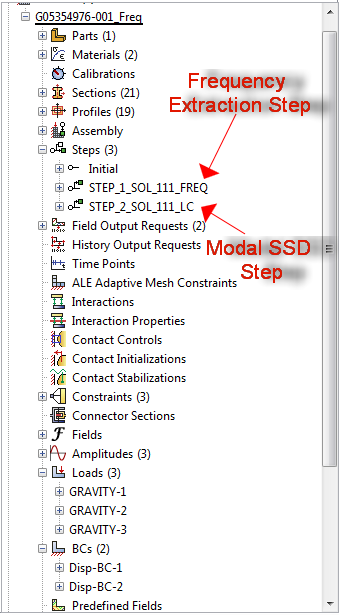

I have the following analysis setup.
I have 3 load cases defined (LC1, LC2, LC3). Further, I am performing a two step analysis. The first step is a Frequency (Natural Frequency Extraction) followed by a 2nd step which is a Modal Steady-State Dynamics.
I have a set of interested frequencies defined for the 2nd step. I am still learning on how to set up the analysis properly.

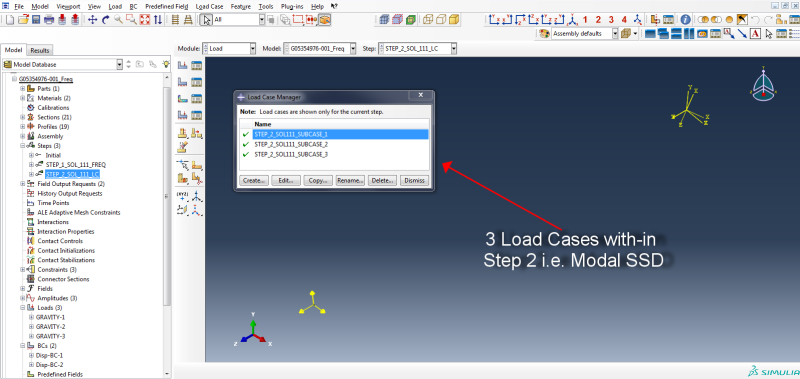

I assume you mean that you have 3 different SSDs after the frequency extraction.
If the settings for the SSD are equal and just the loading is different, then you can use one SSD step and 3 Loadcases within. For large analysis that would be faster than 3 steps. But it makes no difference for postprocessing. See Analysis Users Guide 6.1.4 Multiple load case analysis

Thanks for the response. I think Abaqus treats multiple load cases just like multiple steps if I am correct. Anyways, I am attaching a couple of images to make my model setup clear.
If I could sort outputs based on Step as well as Load Cases for my situation, it would be great.

1. You can also use 3 SSD steps after the frequency step if you like and ignore the loadcase functionality It's just slower in the solver, but that's all.

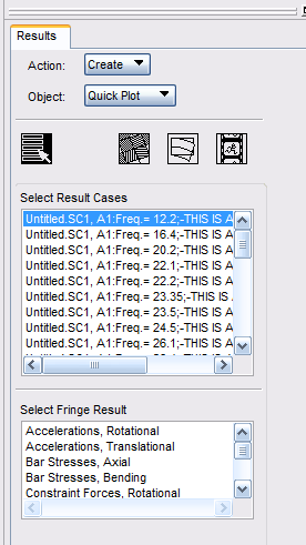

3. This is how results cases appear in MSC Patran post-processing module.
And this is the format I get in Abaqus.
Somehow, I feel that Patran format gives me better continuity (since I can just scroll through all results for one particular load case frequencies sequentially before I proceed to the next Load Case). I was hoping that Abaqus would let me arrange (using filter or any other means) freq modes for each load case...but using Steps would alleviate I guess.

1. The 3 SSD steps would not interact which each other and also not continue things. Each linear step acts independent. Only nonlinear steps with NLGEOM change the state of the model for the next step.

3. With 3 steps and only one result frame per frequency you might have something similar like in Patran.
