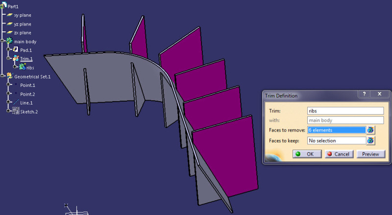

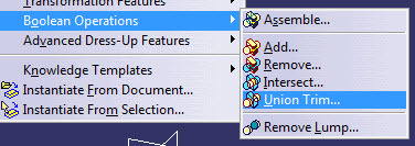

For the rib work and stiffeners I would create them in a separate part body and then use a Trim Boolean function to add them to the main body.

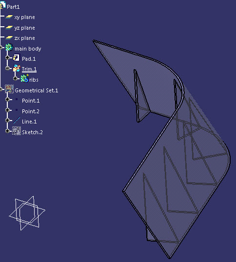

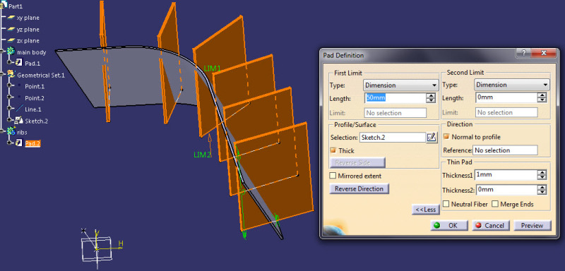

You could try something like this (I'm using simplified geometry to illustrate the principle of Boolean Trim):
Step 1/4
Step 2/4
Step 3/4
Step 4/4

Generaly, stiffernes on this model i make individually, first slots. Easy way is create positioned Sketch on slots and then make Sktech of stiffener and then Pad. And that is new Body.
Other elements is simply to create with planes, translate command,rotate by axis, Mirror, and Pad.
Part is symmetric, and left vertical and right vertical side is symetric.
