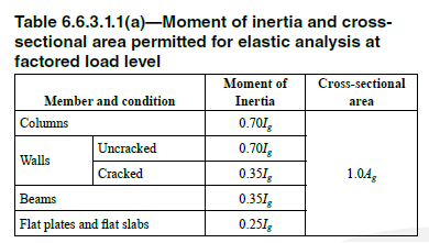

As in Table 6.6.3.1.1(a) of ACI 318-14:
Do I need to use the ACI Moments of inertia and apply a adjustment to stiffness? what adjustment to stiffness?

I don't know that you're going to see an authoritative reference on this. But, what you posted about the AISC design guide is pretty close. Especially when combined with that ACI table.... It seems to me like you did a pretty good job answering your own question!
Ultimately, this will be a question of engineering judgement. Estimating the proper concrete stiffness to use in an elastic analysis is always a matter of judgment. Even more so, when you throw in Direct Analysis Method.
Some might even suggest increasing the reduction from that ACI table by an additional 20%. Or, analyzing it both ways. One for the concrete design (where the concrete elements are not reduced by as much) and one for the steel design (where the concrete members are reduced more).

Thanks JoshPlum, but can I use the moment of inertia fron table 6.6.3.1.1.(a) with adjustment to stiffness = 0.8 (columns = 0.8x0.7xIg and for beams = 0.8x0.35xIg)?
Or only the the moment of inertia fron table 6.6.3.1.1.(a)(columns = 0.7xIg and for beams = 0.35xIg)?
Or with another coefficient?

Well, let's think about what the goal is for each of the various stiffness adjustments.
For the 0.8 Direct Analysis Method reduction, the point is to approximate the "inelastic buckling" of the steel structure by artificially increasing the P-Delta effect. This doesn't reflect a real change to the stiffness of the structure.
The ACI stiffness factors are there to represent the cracking of the structure. Since concrete is not an elastic material, this is also an approximation. However, it does represent a real reduction in the stiffness of the structure.
Now, if the combined structure uses a the DA Method to reduce steel stiffness and the ACI method to reduce concrete, then the steel members are slightly less stiff than they would be (if this were an elastic analysis).... which means the concrete members will be designed for slightly higher forces. Conservative for concrete, but un-conservative for the steel.
Now, if the combined structure uses the DA method to reduce steel stiffness and the ACI method + an extra 20% stiffness reduction, then the concrete is softer than it would be (if this were a pure elastic analysis per ACI). Therefore, the concrete members will have slightly lower forces. Conservative for the Steel, but un-conservative for the concrete.
In reality I think either method is probably okay. The estimate of concrete stiffness is very rough and probably not that accurate. But, if you want to be guaranteed to always be conservative then I would run it both ways.
