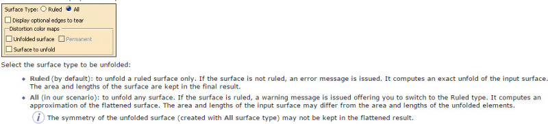

Unfold Command Help
Unfold Command Help
Unfold Command Help
I am trying the use the Unfold command on a complex curvature surface. The base surface has a edge/isoparm down the centerline with the Y coordinate on 0.000. When I unfold the surface that same edge/isoparm is on 0.000 on the same side as the origin points used in the command but the other side of the unfolded surface is of by almost .25in. Is there an option or extra command I am missing to adjust this deviation or is it just the way CATIA handles the unfold command?
I am trying to use the unfolded surface as a guide to send curves back to the original surface.
Take a look at the picture below for clarification if my description is unclear. You can also see that the Y values on the unfolded surface are no symmetric around the ZX plane.
Ryan Capriglione
NX/CATIA Power User
RE: Unfold Command Help
Are you unfolding exact or approximate?
If you are dealing with the SMD (Sheetmetal Design) workbench then the K factor controls whether the geometry is longer or shorter when folded/unfolded.
Drew Mumaw
www.textsketcher.com
www.drewmumaw.com
RE: Unfold Command Help
unfold does not keep symmetry or other geometrical specifications... work as design. SR closed.
Eric N.
RE: Unfold Command Help
I am using the unfold command out of CPD. It seems as though this is a bit of a short coming when it comes to CATIA. How can I guarantee that the flat pattern is correct if I can't verify the symmetry of an unfolded surface.
Ryan Capriglione
NX/CATIA Power User
RE: Unfold Command Help
maybe the CPD computation differ from the DL1... check with DS.
Eric N.
