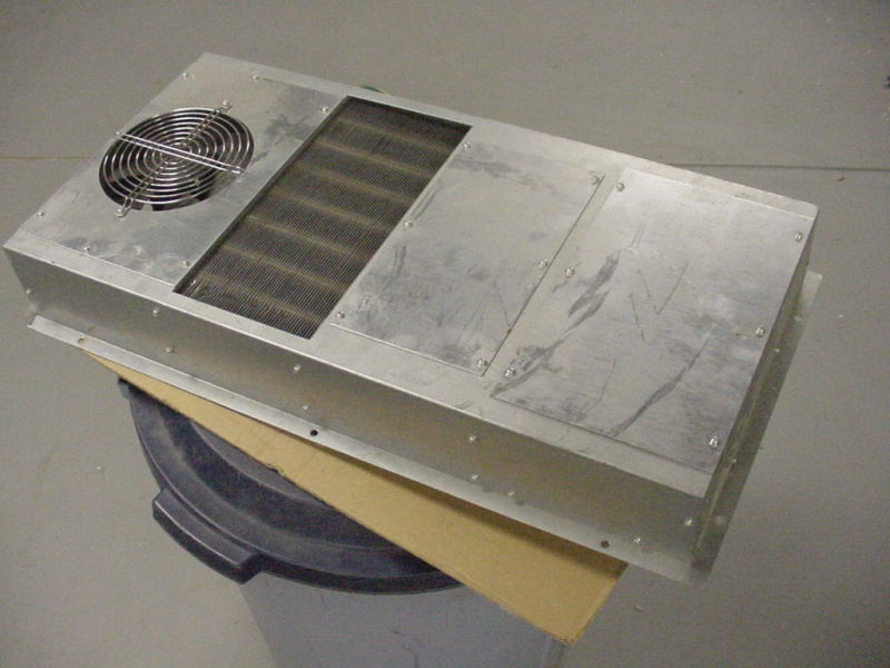

In lue of fans I've switched my customers to heat exchangers. They are the ones with two fans. One blows dirty outside air across the outside top end of the heatpipes and the other blows clean inside air across the inside bottom end of the heatpipes. No air exchanges with the inside of the enclosure at all. It's saved a lot of machinetools from coolant mist and ceramic dust.
There are primarily two types.
One has a horizontal flange and mounts thru the top of an enclosure. It works well because the hot air at the top inside efficiently drives the thermal transfer.
The other style mounts on the enclosure door or side having a vertical flange.
Keith Cress

I like heat exchangers too, but they require at least a 10degC delta if I recall. Side note Keith, that technology was developed here in the Bay Area at a company that is now called Noten, origianally for the stantions used to hold the Trans-Alaska Pipeline off of the permafrost. They couldn't let the heat of the oil get to and melt the permafrost, but there was no power available to run anything active, had to be totally passive.
"You measure the size of the accomplishment by the obstacles you had to overcome to reach your goals" -- Booker T. Washington
