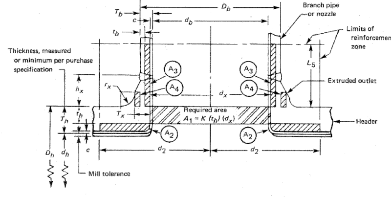

B31.3 - 304.3.4 Reinforcement of Extruded Outlet Headers
RE: B31.3 - 304.3.4 Reinforcement of Extruded Outlet Headers
Only the extruded part, which, practically speaking, is 1/2 the width of the weld.
NO. When the tee is extruded there is no weld.
I don't see any "gray area", only a clearly drawn diagram and set of notes.
What is not clear about it??
if you look at this figure, hx goes above the collar extrusion
I don't think it does and the description is quite clear. Height of extruded outlet.
LI, Slow down, have a cup of coffee, read the question well, look at the diagram.
Can he include the weld in determining the height of hx?
I said that he can include 1/2 the weld. (Any discrepency caused by including 1/2 the dimension of the root in the calculation of hx should not be very worrisome.)

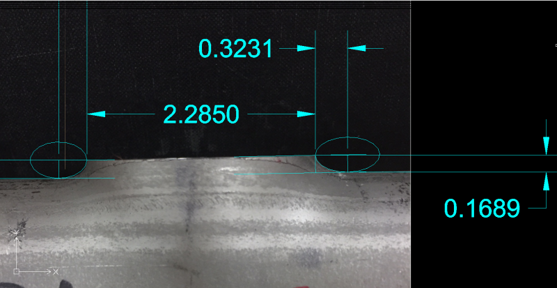

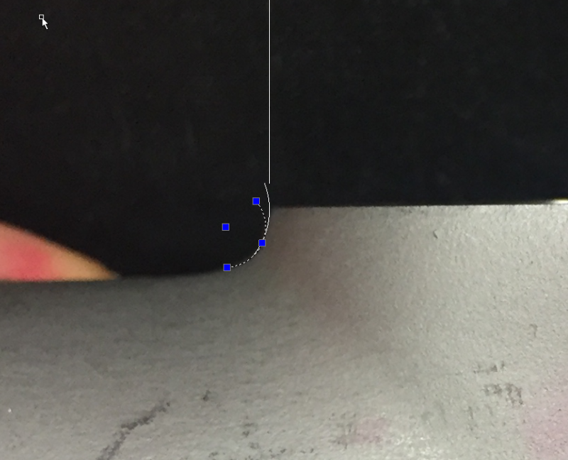

Two more things:
-Please look at my attached image of how I'm measuring the radius (I took a picture and used AutoCAD). It is difficult to choose where I start and end my arc that I create to determine my radius. There are multiply radii to choose on a single side. What radius do I pick?
-Do you know of any better extruded outlet radii measuring techniques/tools I could use?
Thank you

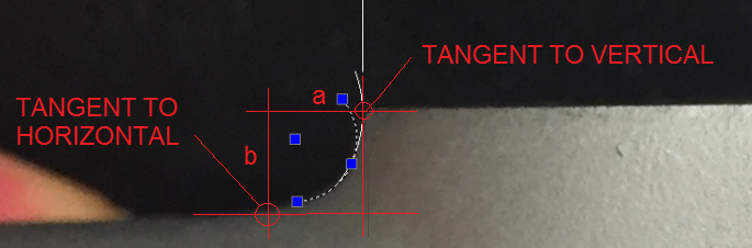

measure a and b, they should be roughly equal, if not take the average value for the radius.
Looks more like an ellipse for most extrusions. Would taking the average radius of the ellipse be good practice? The formula is Average Radius(Ellipse)= SQRT((A^2+B^2)/2), where A is the central, horizontal, transverse radius/semi-major axis and B is the central, vertical, conjugate radius/semi-minor axis.
