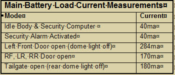

Below are some measurements I did on one of my vehicles that shows the combined effect of the ECU & security computers in sleep mode and in active mode. These measurements were made after I discovered by accident that the driver's door dome light switch not only operates the dome light, but is also used to bring the Main ECU out of sleep mode into active mode in preparation for starting the vehicle and in the process does things like pre-positioning the Idle Air Valve on the throttle body.
The above measurements were made after I had parked the vehicle in the garage with all doors open (and all dome lights off) overnight with a fan outside the vehicle blowing air into the vehicle to dry it out after the wife had spilled a significant amount of water onto the carpet. Much to my surprise, the vehicle battery was pulled down by the ECU staying in active mode due to the driver door being open (and dome lights switched off), to the point it would not start the engine.
Regarding the inrush current after reconnecting the battery with the meter in series, which could be from a number of loads, one that may not be obvious is the use by some manufacturers of fairly large capacitors in the main airbag arming controller to store sufficient energy to be able to fire the airbags and seat belt tensioner system for some time after a collision as the vehicle battery/wiring located well forward in the engine compartment may be destroyed in the initial phases of a multi strike collision. In my Toyota this energy storage system is kept charged by the battery even with the vehicle off.
Maybe the above will provide some reference to what you should see in your measurements and also some not so obvious effect of the ECUs not going into sleep mode due to some issue in that area. Obviously factory service documentation on your vehicle would be the best bet for you to know what to expect. And as stated above pulling fuses is a good way to isolate down to he circuit causing the drain.
