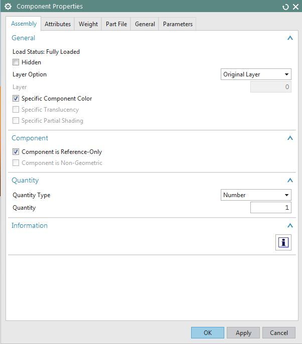

complete part list not shown in nx 9
RE: complete part list not shown in nx 9
i assume that you are using a out of the box parts list.
This is built for master modeling.
You have created the drawing in the assembly file. ( which isn't according to the master modeling principle.)
The assembly structure will then be "not as expected" .
The drawing should be in a file of its own, above the assembly.
RMB the partslist ( graphics window or Part Navigator) - Edit Levels.
toggle on or off the "master model" button.
Regards,
Tomas
Please check also your component properties (RMB on a part). The option "component is reference-only" should be unchecked.
